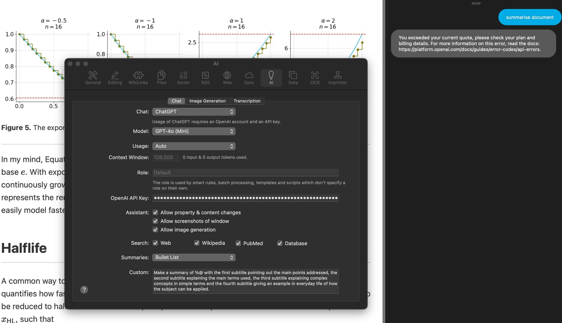

I subscribed to DT4 as I was drawn to the new AI integration and I also want to keep supporting its development. I mainly just use ChatGPT in a browser and I think it would be great to be able to select a document in DT4 and have a LLM summarise it down to bullet points. However, I’m struggling to understand how API access works. I obtained an OpenAI API Key, but receive an ‘exceeded current quota’ message when I try a query (see attached), so I must need to pay for something.

Depending on your account’s tier, the quota and tokens per minute are limited and not all models are available.

The entire AI industry has an entirely separate subscription/pricing structure for use of web-based chat features (such as ChatGPT or Perplexity) vs programmatic use of an API (which Devonthink does). There is no way around that.
There are some sofware vendors who get around that by charging a flat rate and hoping usage averages out among their customers; clearly that model is doomed to either fail or result in very limited AI features.

And we have to work within the boundaries set by the AI provider. Third-party access for an app like ours requires using an API key
