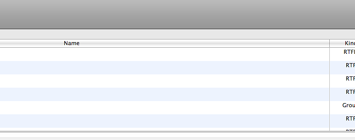

I tried to follow your example on a database I happened to have open:
Assuming, I ran “git (svn NOT workflow)” as a search, it should return all documents containing the words “git” and “svn”, and do not contain the term “workflow”, correct?
However, the search results still contain documents containing the term workflow:
Searching is (like in v1.x) field specific, the content is probably matching the term. That’s necessary for proximity/phrase searching and to make results consistent, e.g. word1 NEAR/9999999 word2 returns the same results as word1 AND word2.
Try expressing the query differently, as
(git svn) NOT workflow
That query looks for documents that contain both the terms within the parentheses, then filters out those that contain “workflow”.
Got it - limiting the search to either only “Name” or only “Content” gives me the expected result. It’s just “Search All” that gave me an unexpected result.
