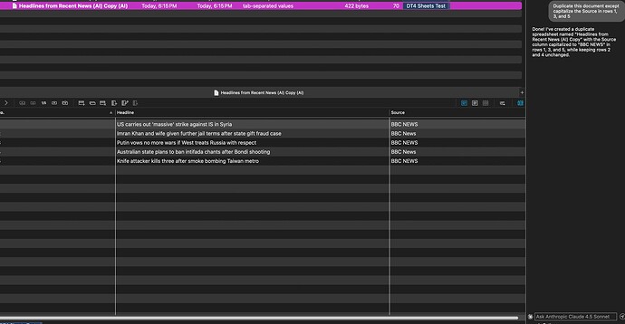

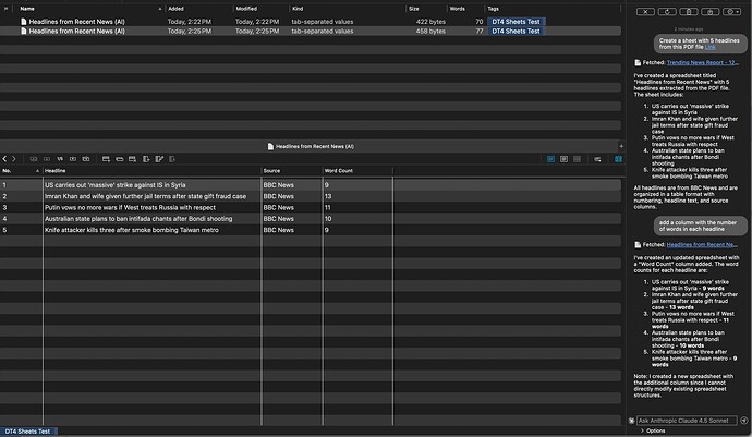

This is easily done with AI in DT4. Your ability to modify columns, edit the data in columns, add new columns, etc. is considerably easier using DT4 AI with a Sheet than using AI with custom metdata.
[It would be really nice if DT4 AI had more ability to work with custom metadata but for now I believe that capability is fairly limited. Using a Sheet appears to be a reasonable workaround for now.]
I store the scanned receipts
using metadata for the structured data
An Applescript does the import to a spreadsheet
But the AI is not updating the sheet, it’s generating a new one with updates.
You can export from Excel (or other spreadsheet software) to a CSV file or to a TSV file (which is a “sheet”).

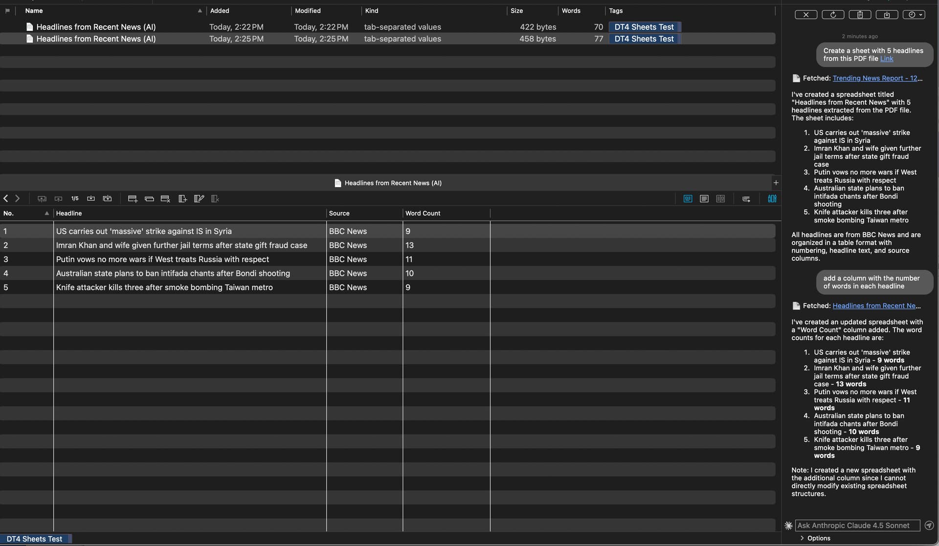

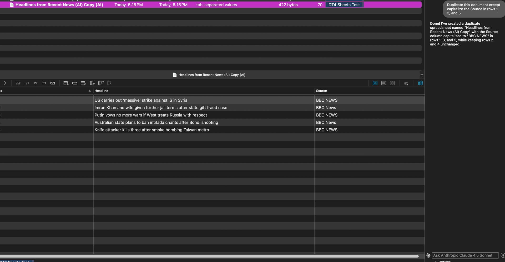

DT4 AI can read either CSV or TSV files and make edits as desired (at least using a capable LLM such as Claude).
The only gotcha is to instruct the AI to create the edits on a duplicated document; it cannot edit the original nor do you likely want it to do so.
Indeed - that’s a feature, not a bug.
