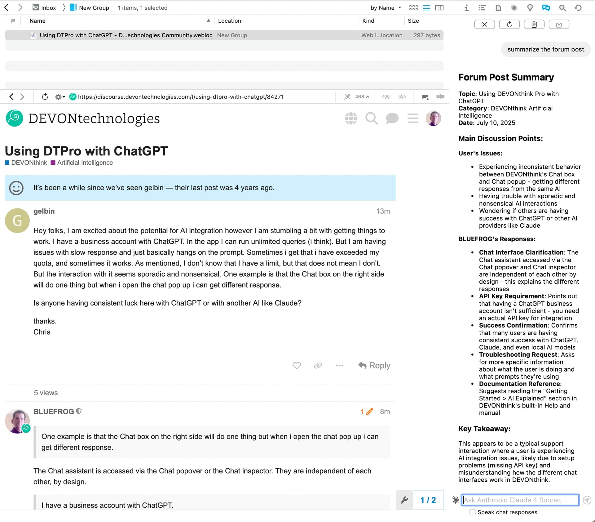

PS: Just as a potentially practical example…
:slight_smile:
Forum post viewed and AI-prompted directly in DEVONthink with Claude Sonnet 4. Lower-tiered models, e.g., Haiku 3.5, may not be able to accomplish this, but testing of models from other AI providers would need to be done to determine this.

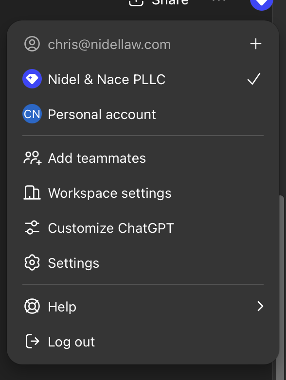

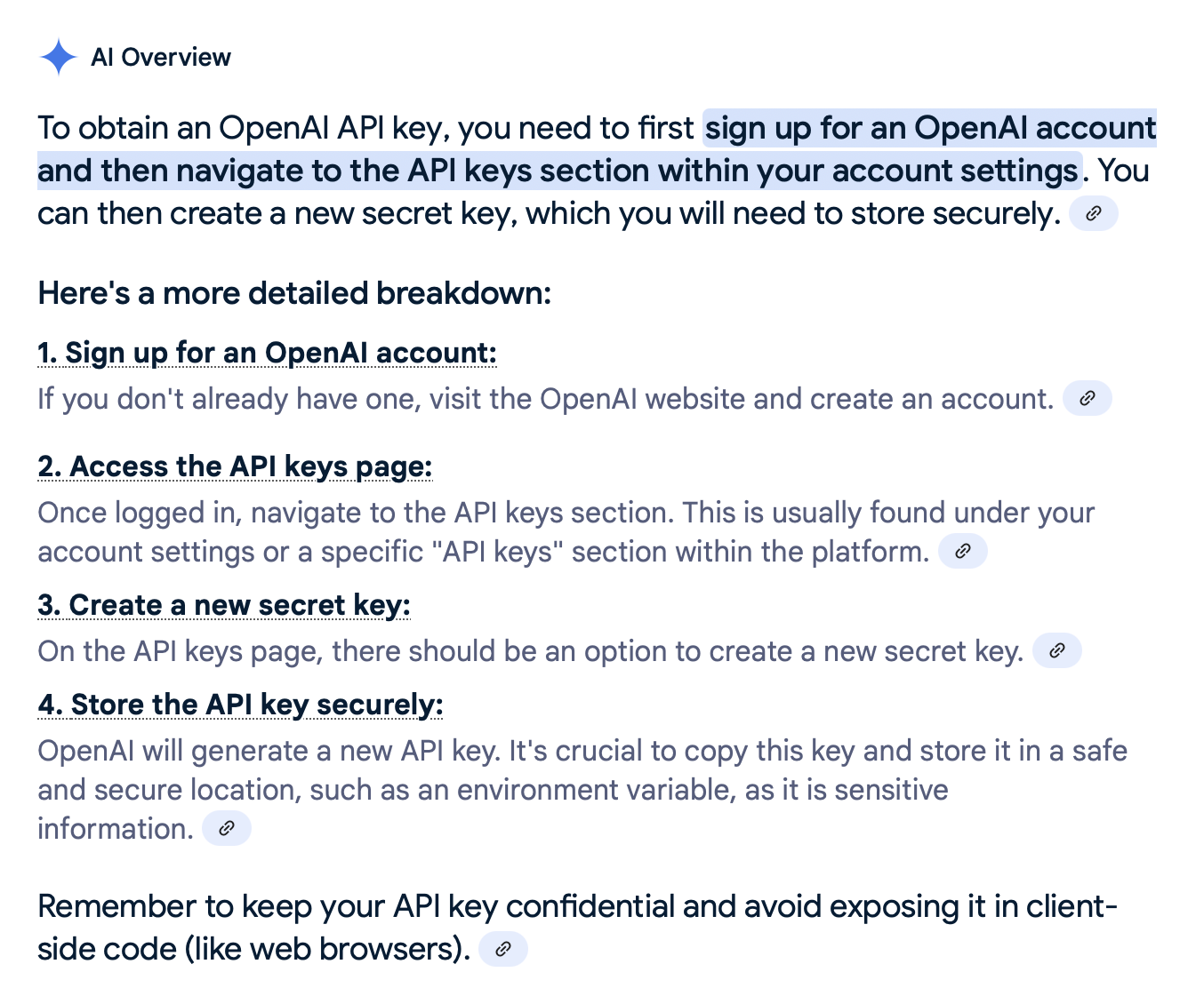

I am wondering if there is an issue with having a personal account that is free and a paid account. I have the paid team ChatGPT but it seems that my api key is perhaps out of my personal account. If that is the case, maybe the paid account does not provide an API key? I am thoroughly confused because when i go to my account i have personal and the paid. but when i go to create the API it seems like its one and the same.
I have tried a variety of models including the mini and nano.
i think it is an account issue maybe or maybe there is no such thing as a paid account api key.
Yeah, I’m not sure on that point. I’m thinking you just have a chat-based account, which is not the same as API access.
Try logging in here…
https://platform.openai.com/api-keys

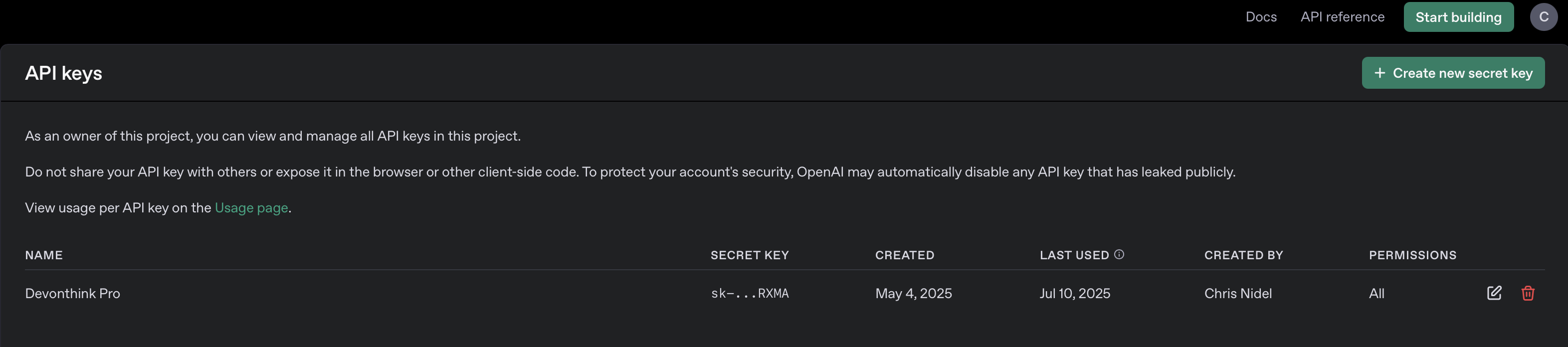

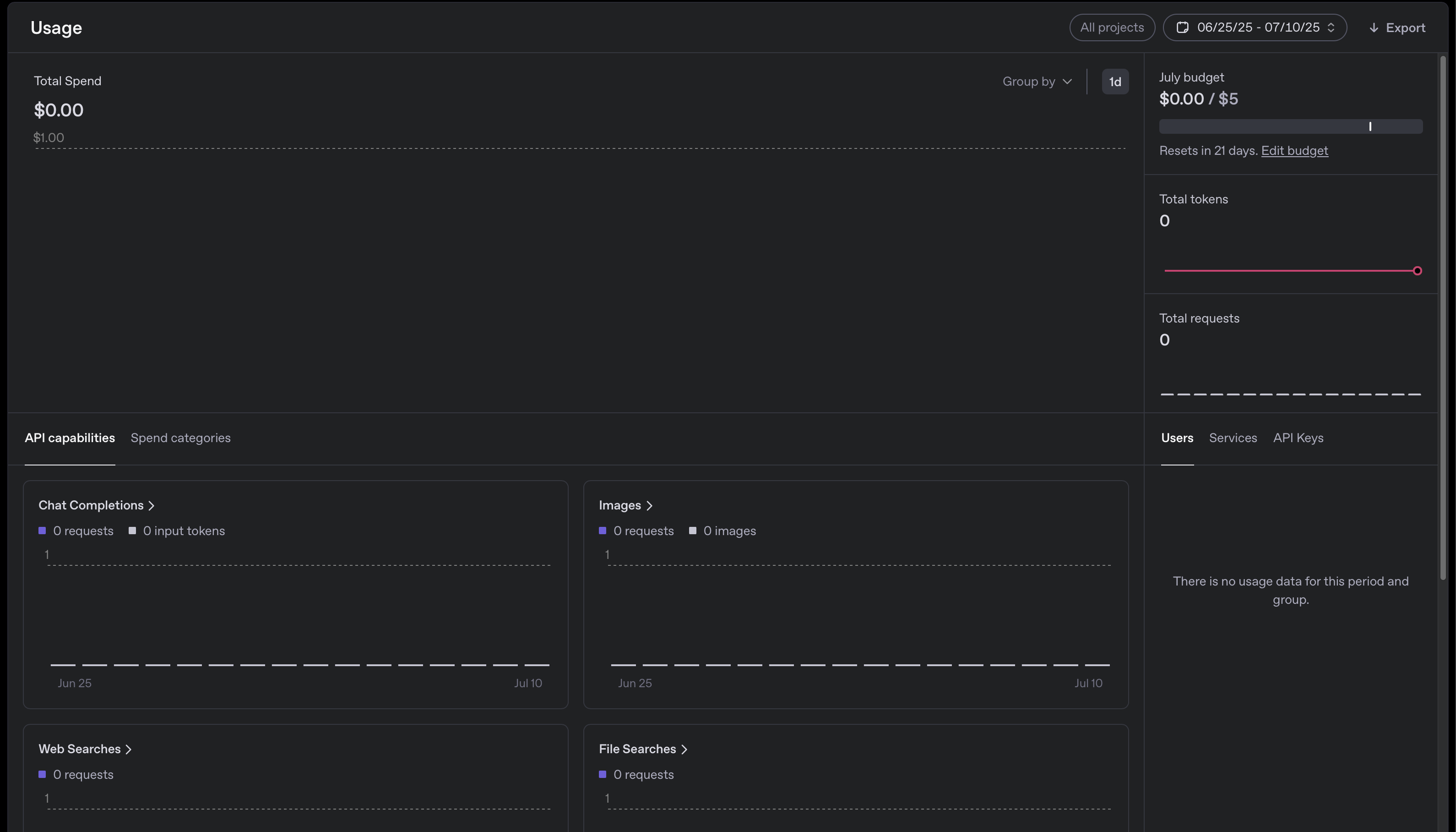

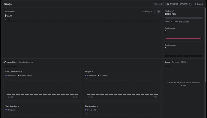

this seems to indicate that i have an API from my unpaid personal account. but it also shows no activity. so not sure why its sometimes telling me i am over the quota.
And you entered that API key in DEVONthink’s AI > Chat > OpenAI API Key field after selecting ChatGPT as the AI Provider?
