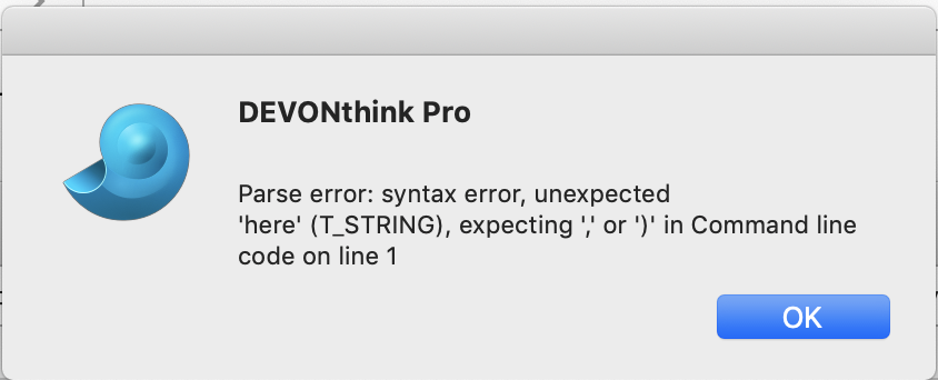

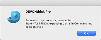

Sorry, I meant my applescripts in DT3. I turned out to be trivial though. I am not able to run the script on special characters at all in the new account. It works fine with no special characters, but otherwise, I get this error (when trying to run the script on the text ’ Testing “here is some text” '): “Parse error: syntax error, unexpected ‘here’ (T_STRING), expecting ‘,’ or ‘)’ in Command line code on line 1”.
A screencap of the error could be useful.
Here it is:

This line…
set theStringEncoded to (do shell script "php -r 'echo trim(urlencode(" & "\"" & theString & "" & "\"));'" as string)
…should probably use the quoted form of theString.
Thank you!! But isn’t it using the quoted form of theString already?
No, in that line it’s still the selected text which might include characters that need quoting for the shell script.
