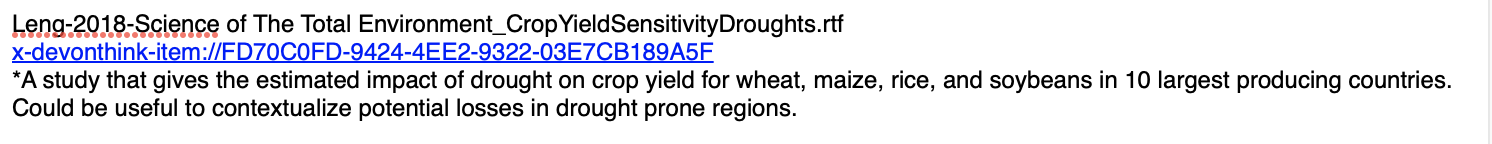

Thanks for this! Is there a way to setup newLink in the clipboard so that when I paste the clipboard contents, the link is active instead of just the string?
Please clarify what you’re referring to, including any helpful screencaps.
Yes, right now I am using the code you sent above and sending it to the clipboard:
set the clipboard to (recordName & return & newLink & return & selectedText)
This gives me the following when I paste the clipboard into a text file:
However, I want to paste the active link, like this:
Define text file.

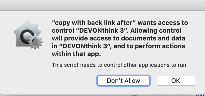

Bluefrog, the text files I am using are always RTF files, though I also want to be able to select text from PDF files. The code from korm is working great except for two issues:
  1. for some reason, even when I am selecting text from an RTF file, the error ‘Source should be a PDF or RTF’ is activated. I don’t know why it doesn’t recognize the kind of these files as RTF. I have tried multiple RTF files. It works fine for PDF files.
  2. I can run the applescript without any issue when I remove the error check for a PDF or RTF file, but when I turn the script into an application (which I need to do in order to turn it into a service to assign a keyboard shortcut), I am asked to allow permission (see below) every time I run the application. Is there a way to automatically grant permission in the code or universally on my computer?
    Thanks
Does anyone have any advice about how to give the script access control within the script so I don’t have to keep Allowing Control every time? (see immediate previous comment). I can’t figure out how to do this. This pop-up does not come up when I just run the script from within DT3. However, to assign a keyboard shortcut, I have to make it an application to turn it into a service, and when I do that and activate the keyboard shortcut, the pop-up appears asking to Allow Control each time.
This is an Apple issue. Try opening the Folder Actions Setup, Apple’s own app, in the Finder.
Every. Single. Time.
By the way, kind is a localized string value. This means the kind on my system is Rich Text Document but on a German system it would be RTF-Dokument.
Using type is the more portable method, and coercing (type of theSelection as string) is even a little safer.
I’m sorry, I don’t understand. How would attaching a script to a folder action in apple solve my issue? Forgive me, I’m a bit new at this. Thank you for the tip on RTFs.
It doesn’t. I was showing an example of the behavior in macOS Mojave. The Folder Actions Setup is Apple’s own app and yet it requires you to okay running it, every time you use it.
Is there any other solution to attach a keyboard shortcut to copy a selection of text with a back link to the file it is in that would not involve having to Allow Control at every instance?
Where is your script saved on your machine?
~/Library/Application Scripts/com.devon-technologies.think3/Menu/My Scripts/
See Help > Documentation > Automation > AppleScript > Script Shortcuts
:slight_smile:
