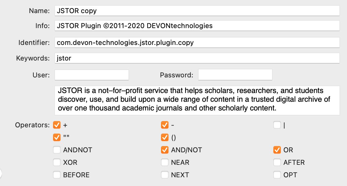

I’m trying to use the JSTOR plugin, but I have university access, so I would need to use a proxy. I tried to create my own JSTOR plugin using the proxy link provided by my librarian: http://proxy.library.emory.edu/login?url=http://www.jstor.org. I’ve also gone ahead and authenticated using that URL in the DEVONagent browser before attempting the search. The plugin I created does not allow me to enter my user name and password. When I try to do a JSTOR search using either the built-in plugin or the one I created I get 0 results.

DEVONagent does not include any built-in or automatic support for proxies. Depending on your proxy it might or might not be possible to write a plugin for it. Hard to tell without the source of your plugin.
I tried including it on a “New Plugin.” It currently says “Searches on the website <proxy.library.emory.edu/login?url=http://www.jstor.org>.” Again, I’m not even sure if this is correct, but perhaps you know of a way to use my university’s proxy to gain access to JSTOR through the search? That would be helpful.
This doesn’t work, the URL doesn’t include a parameter for the search term. It’s probably better to duplicate the existing plugin and to update especially the values of EngineUrland LoginUrl.
Oh, wow, sorry for being dense. Yes, I see it now. I also see the two values you mention. Should I put in the proxy my librarians provided for either or both of those values? Or something else? (Thanks for walking me through this!)
