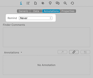

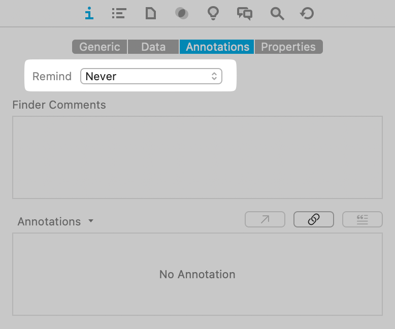

Does the selected document have a reminder in DEVONthink?
Does the document have a reminder?
According to the release notes, the new script is for “mirroring” DEVONthink reminders.
(There was already Scripts > Reminders > Add as To Do to Reminders)
Got it; the note did not have a Reminder, and once I added one the export to Apple Reminders worked.
