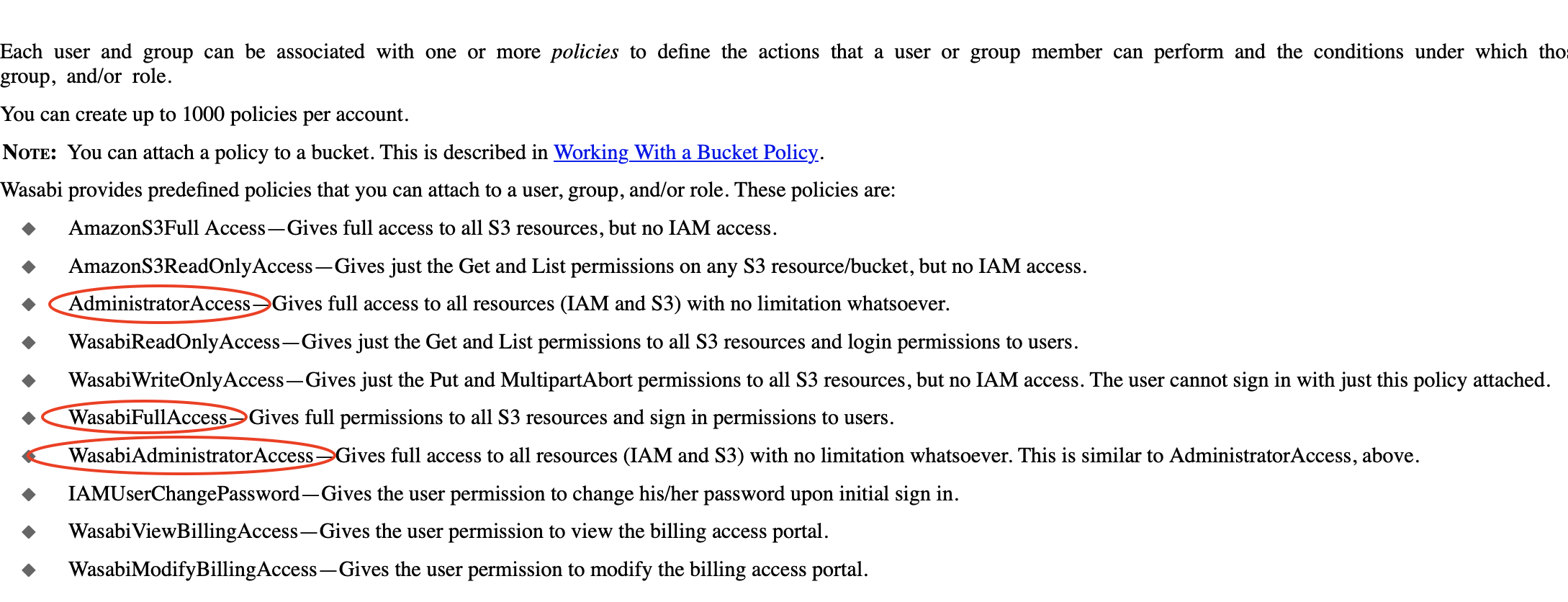

Thanks, I’m using the same settings for Wasabi and compatible settings in Arq. As the only other variable, can you remember how you set the access policy?
Aw geez, I had a feeling you already tried all that.
I can’t remember exactly, but I know it was one of the unlimited ones that wouldn’t restrict Arq.
So based on the options shown here, it was one of the outlined ones, most likely AdministratorAccess.
