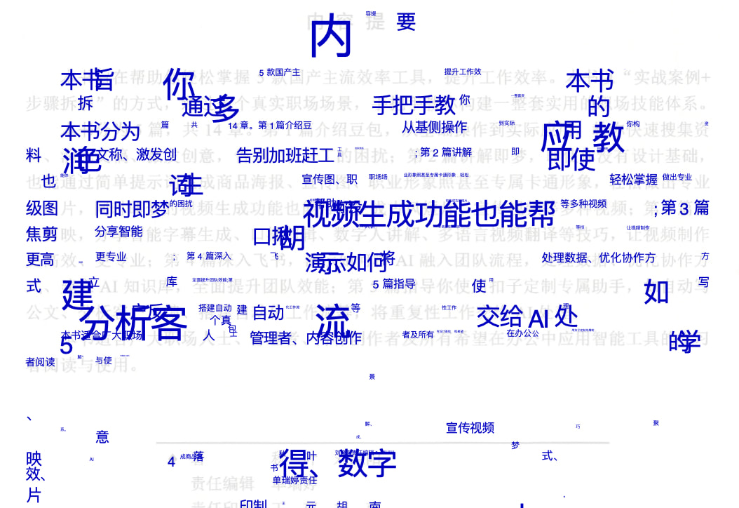

I compared the OCR effect of different software on Chinese. Overall, the OCR effect of the 3rd version is very good, while the OCR effect and viewing effect of the 4th version are very poor, especially DTTG4.
The OCR itself (OCR Layer) might be good, but the viewing experience is not satisfactory.
It feels like ABBYY has not adapted to the new Apple OSs.

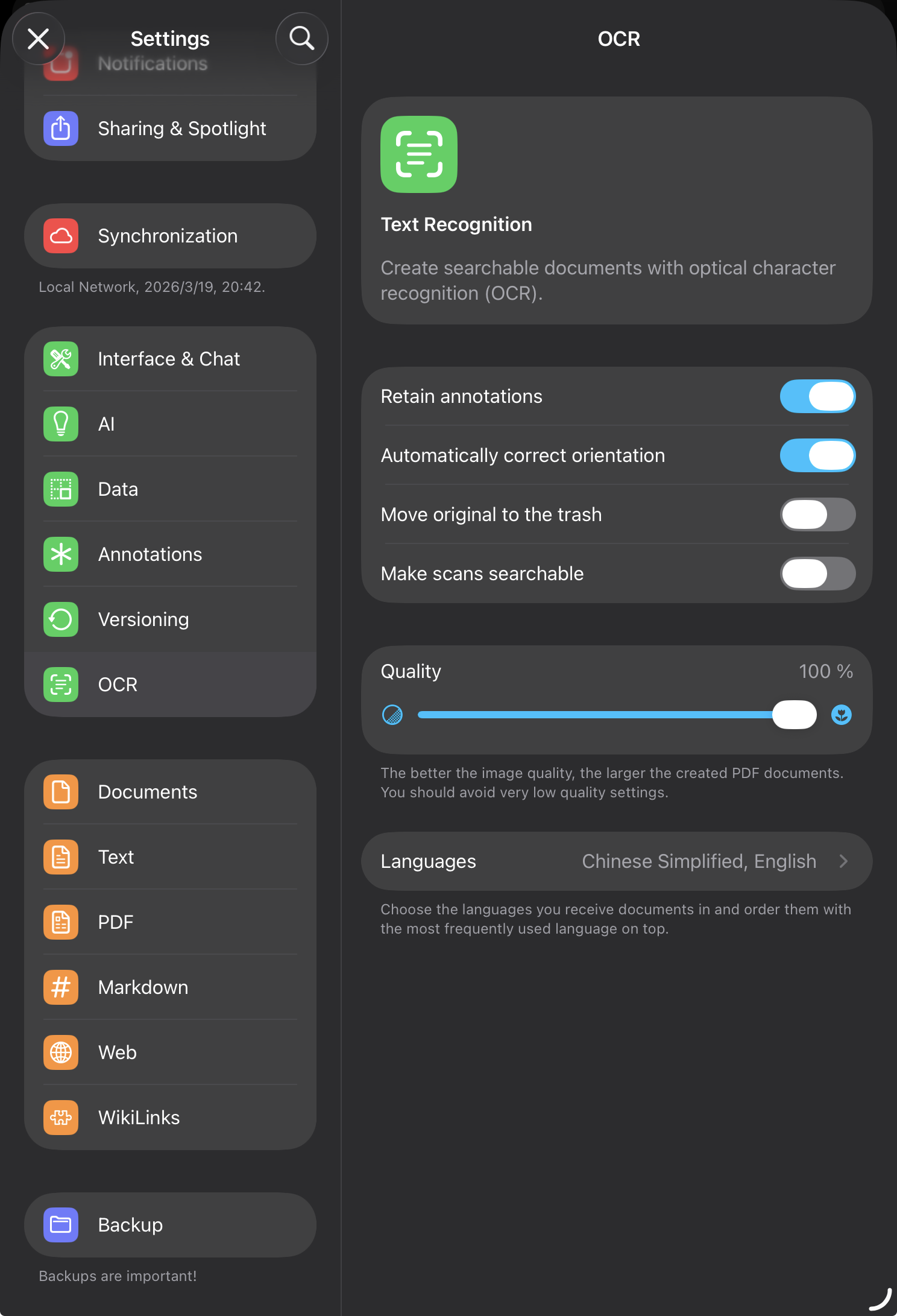

  1. The OCR setting on DTTG only opens Chinese, which is very poor. At the same time, English + Chinese is turned on, and the effect is greatly improved. ↩︎ ↩︎

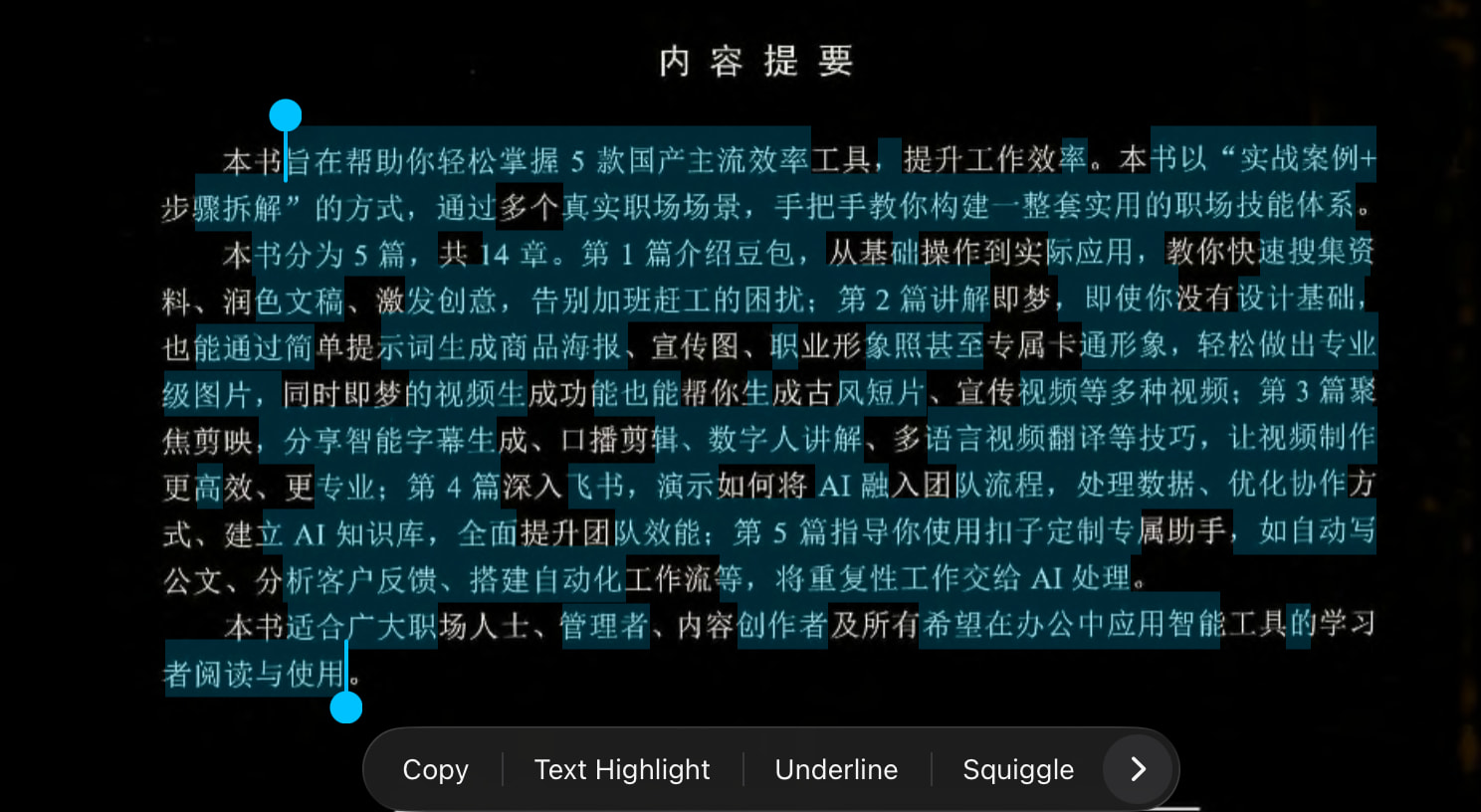

At least, it is certain that files that have undergone DT4 OCR cannot be properly annotated in DTTG4 and DT4 either. (Chinese PDFs)

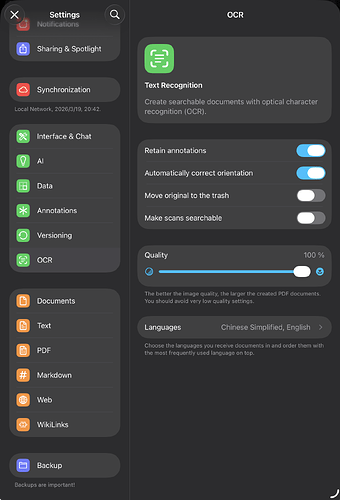

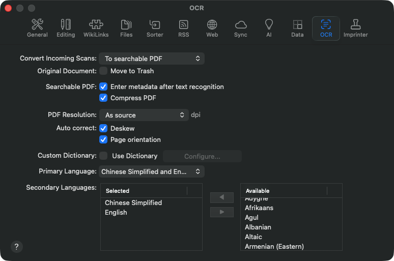

Could you share a document (before/after OCR) and a screenshot of your OCR settings? Thanks in advance!
The conclusion is the same as the Summary above.

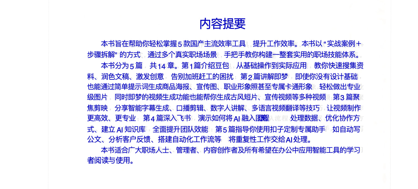

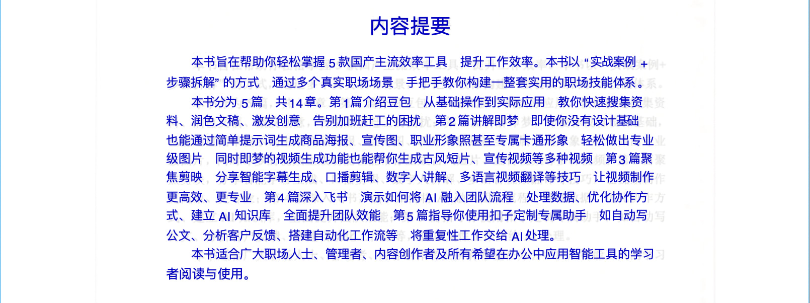

Special notes:

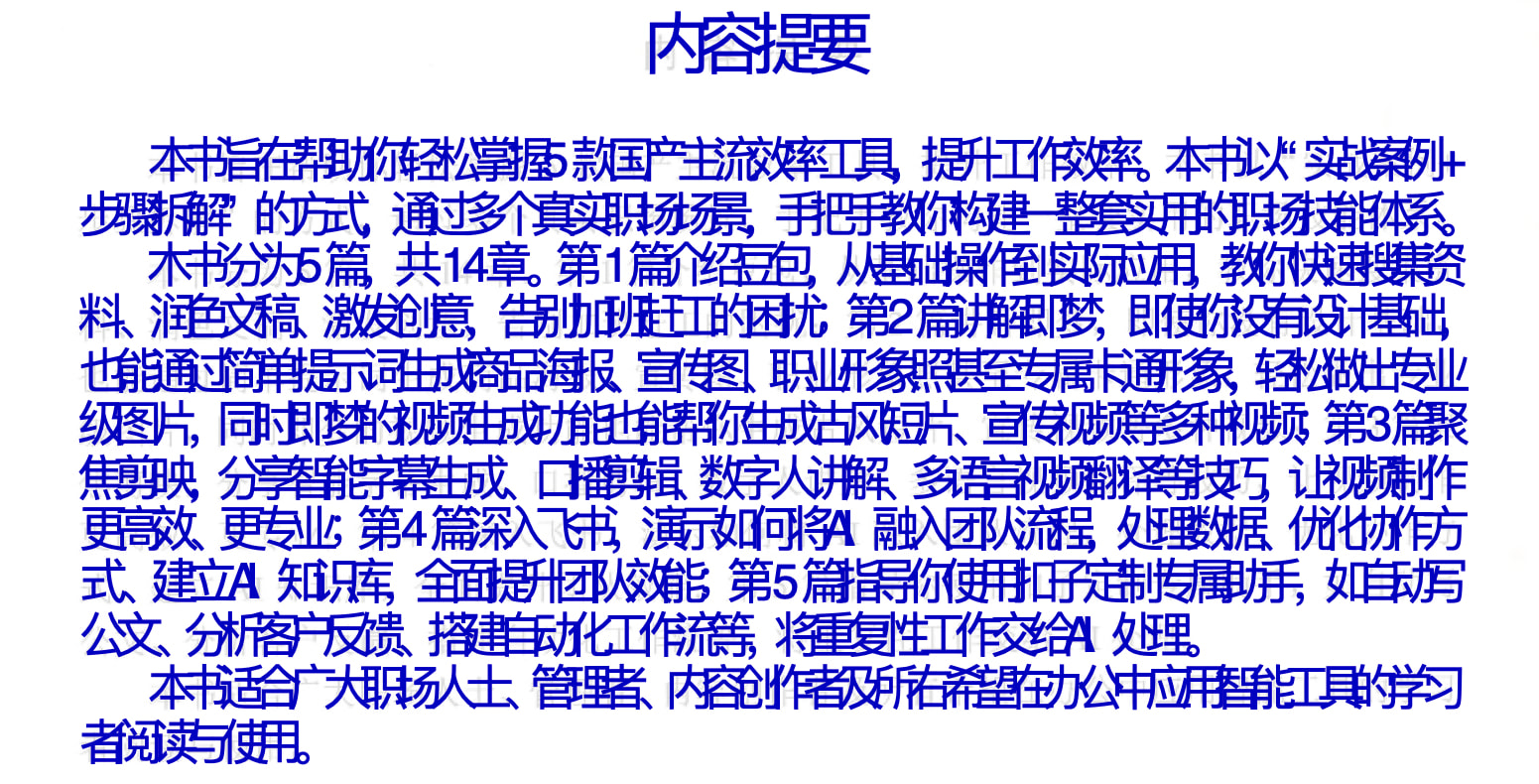

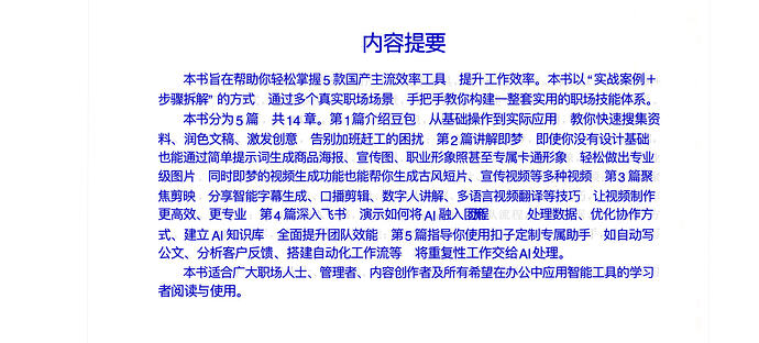

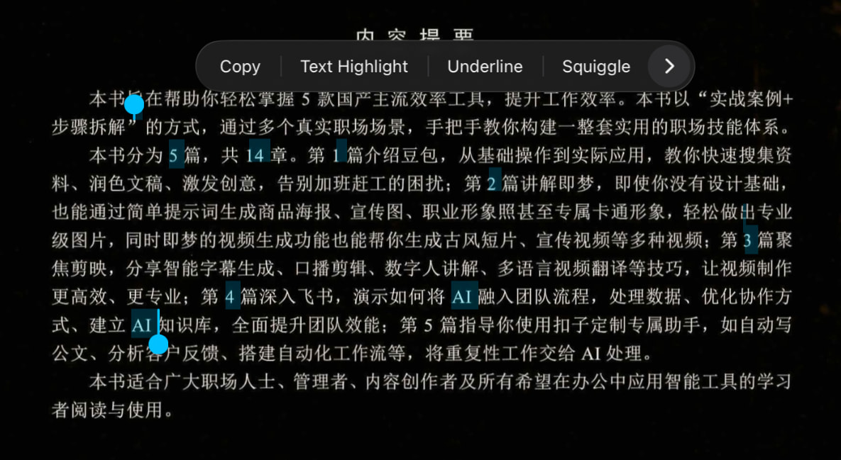

  1. DT4 performs better on documents with similar fonts (such as provided standard files). If there are significant font, boldness, italics differences, etc. on the same page, the effect will be very poor (you can refer to the highlighted yellow parts).

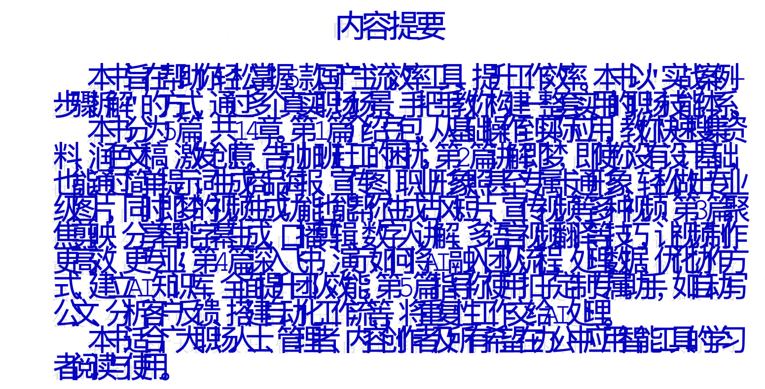

  2. DTTG4 can only provide annotations in English (with notes “HL by DTTG4”).

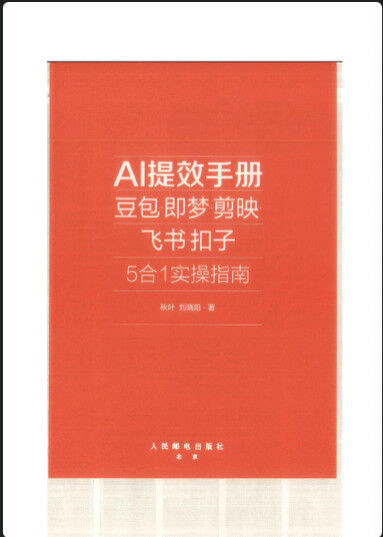

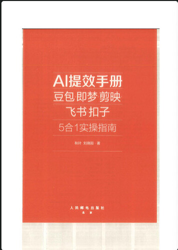

  3. The file size becomes very large after DTTG4 OCR (2 times and 10 times)
The total files are quite large (34M) and cannot be attached here. Are there any other ways I can provide it to you?

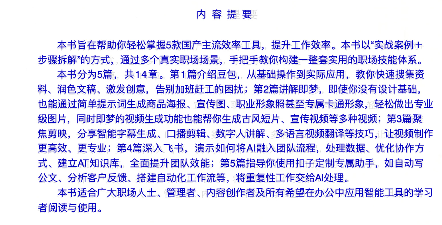

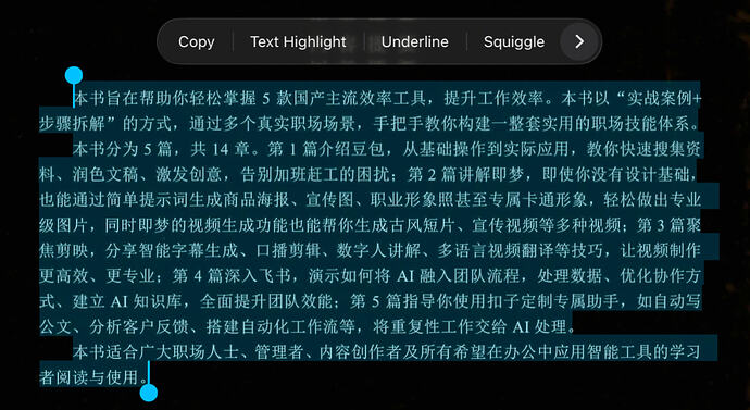

  1. I couldn’t find any issue with the highlighted sections of the documents you sent, the layout and selection of the characters was as expected.
  1. Currently Annotations are not available for some languages as Apple’s PDFKit will corrupt the text layer on saving the file.
  2. We are currently working on improvements to the DTTG OCR.

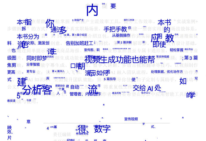

It seems that our results are different. Is there anything I can do to figure out the reasons why I am different from you? Or is this just normal?
PS: This video was recorded after re-importing the file sent to you into DT4

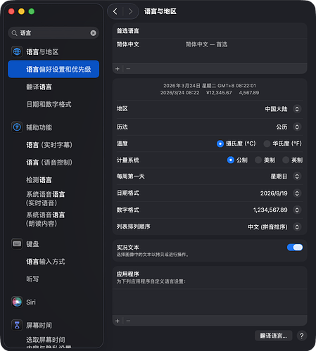

Which version of macOS are you using? I tested on Tahoe 26.3.1
Tahoe 26.3.1(a)
M4 Mac mini

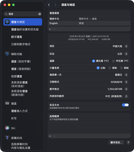

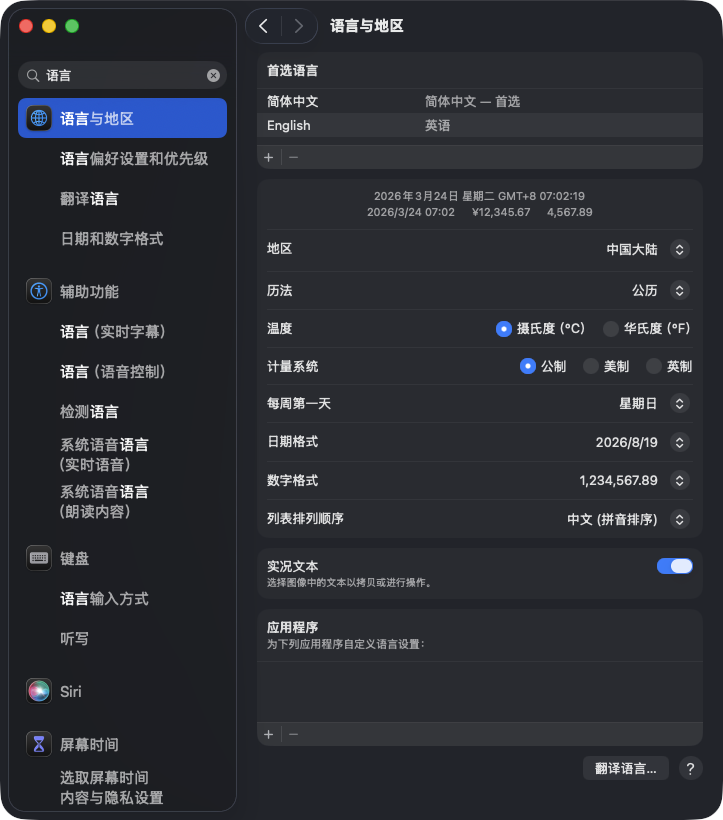

That is very odd, the text selection shouldn’t be different for the same file on different machines. is your Mac system language Chinese Simplified, English or another language?
Chinese Simplified
English
Another Mac Only Chinese Simplified
The result is the same.
I can reproduce your issue with Chinese Simplified as the primary language. It appears to be an issue with Apple’s PDFKit as the incorrect selection happens in Preview too.
Yes, the performance of the preview is the same as that of DT4. It seems that this will be a difficult problem involving Apple’s PDFkit.
