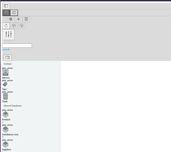

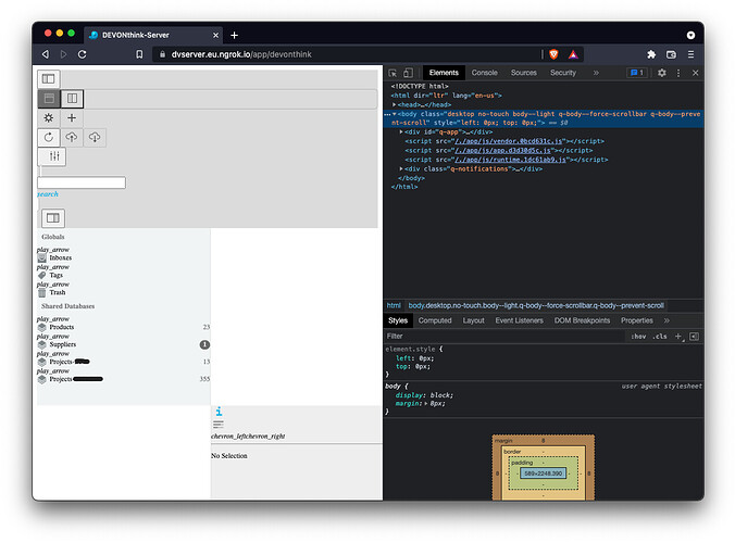

I can reach the web server login page just fine. When I enter the login credentials it either gives me a blank page (Safari), or the attached page of misplaced icons and an attempt to serve some data. If I click around on those icons I do get to see some of the files.

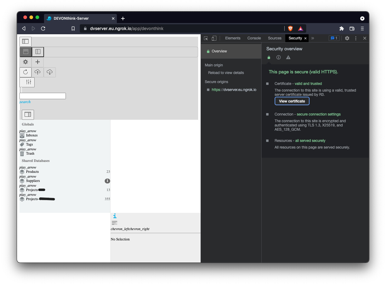

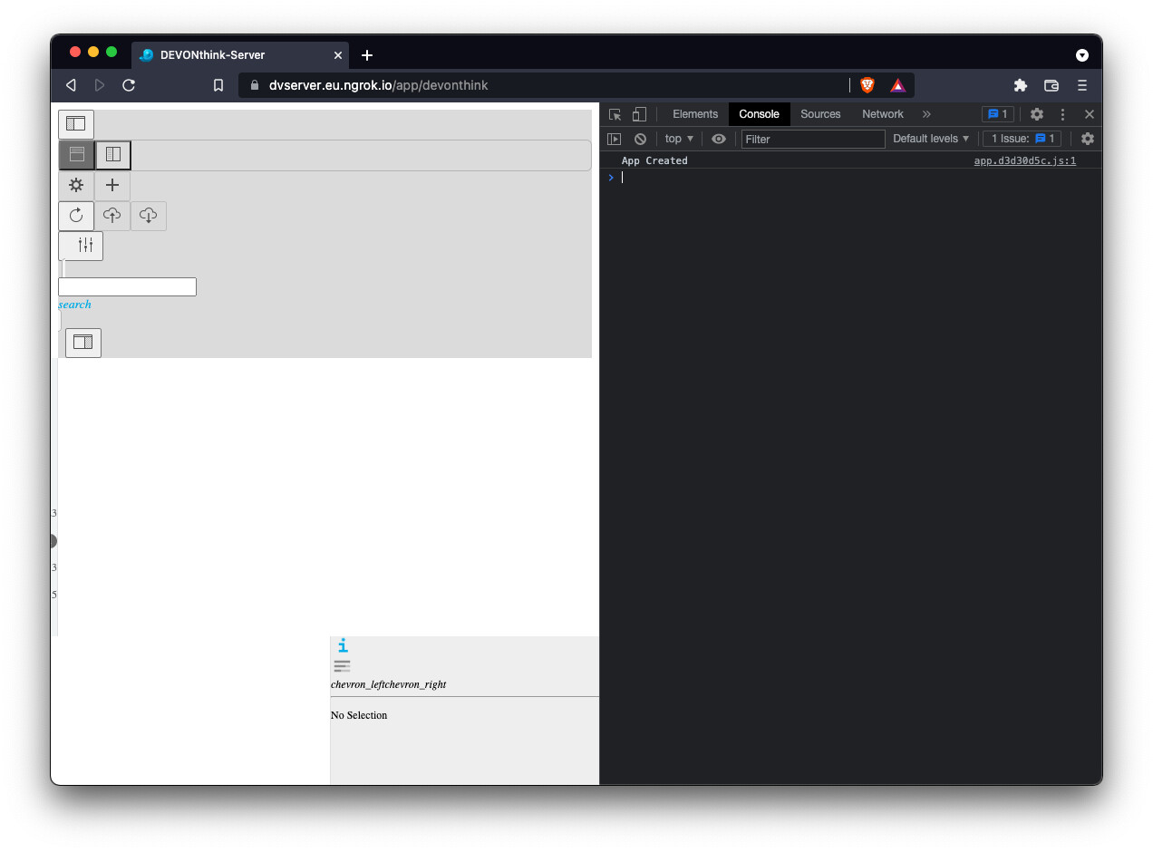

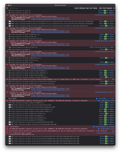

Not sure what to make of the developer info, but these are the screens (Brave browser). Can’t see any errors, and the security connection is ok.

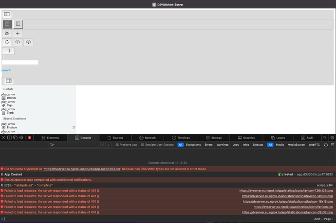

I do have this info from Safari errors, which maybe offers a clue. Looks like the stylesheet was not loaded because of “strict mode”, whatever that is?

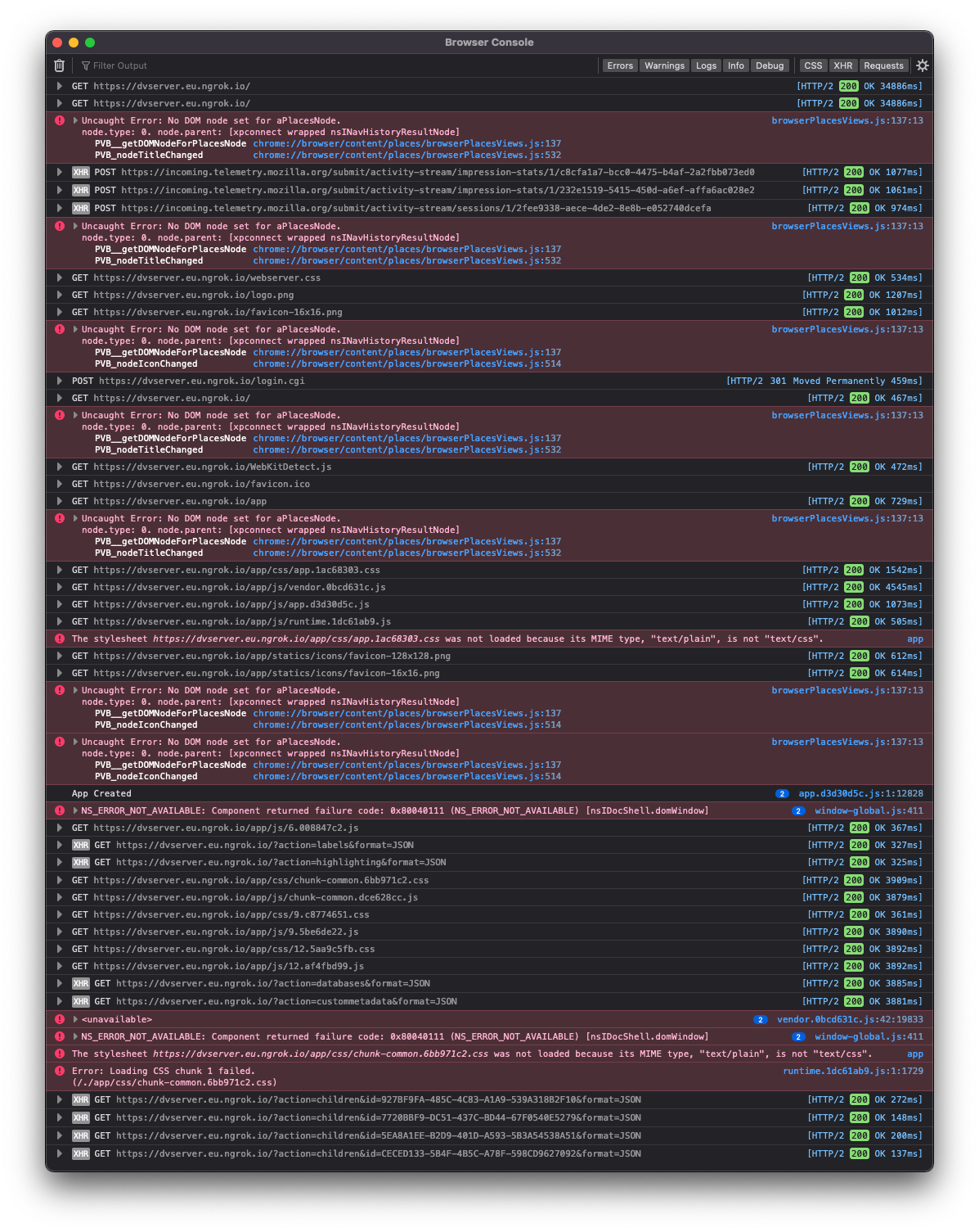

Can you have a look in the Firefox web developer console? I’m not sure about Safari here, but I suppose that it’s Apple’s very peculiar way to complain about a CSP violation. Firefox is usually a lot more verbose about those (and clearer, too).
