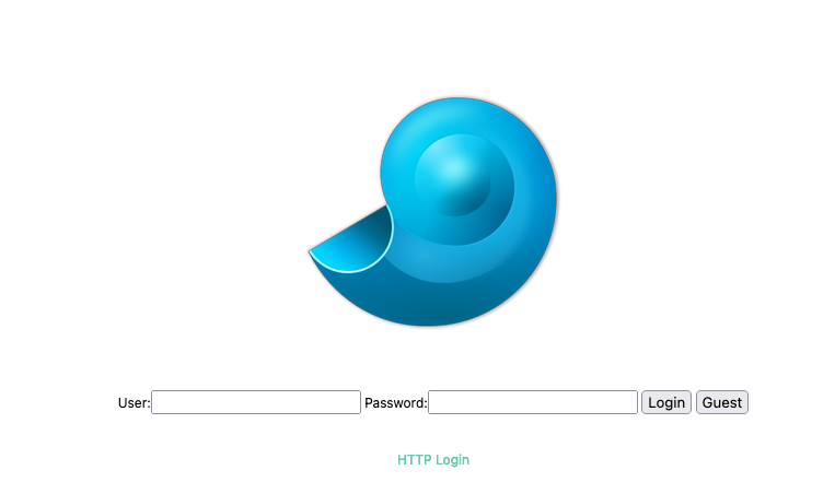

I setup a new user account, new ngrok installation, but same end result. I get this login page no problem.

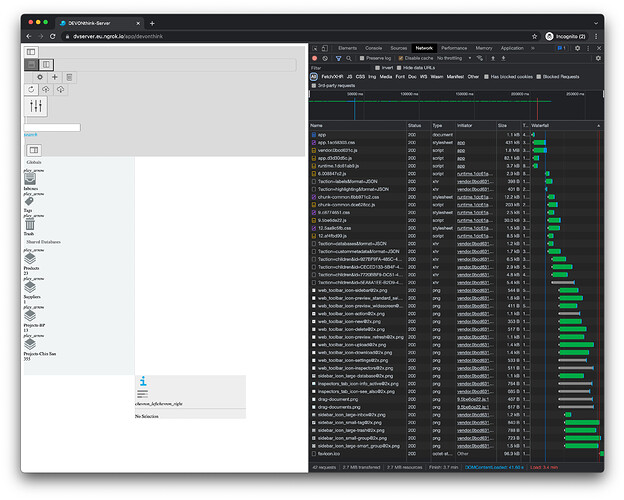

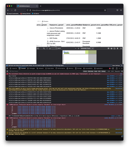

I log in fine, but then I get this rendering in Firefox, and a blank page in Safari. (I can click the buttons and it does work, and I can log out ok).
So strange but thanks for the diligence in trying our suggestions! :slight_smile:
While Safari always gives a blank page, Firefox sometime presents a blank page, and sometimes presents a mixed up layout with odd icons. However, these icons are clickable, and ultimately opens the underlying data like a PDF. You just have to scroll a long way down as all the icons are in a long list. (see image below).

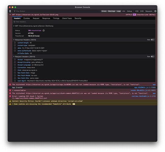

One error which always comes up is the “stylesheet is not loaded”. Maybe that is why the layout is all scrambled?

When Firefox presents a blank page, the console shows a 401 unauthorised error, as well as the stylesheet error. Below are the console outputs if that means anything.…

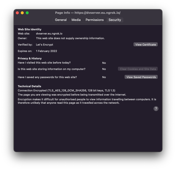

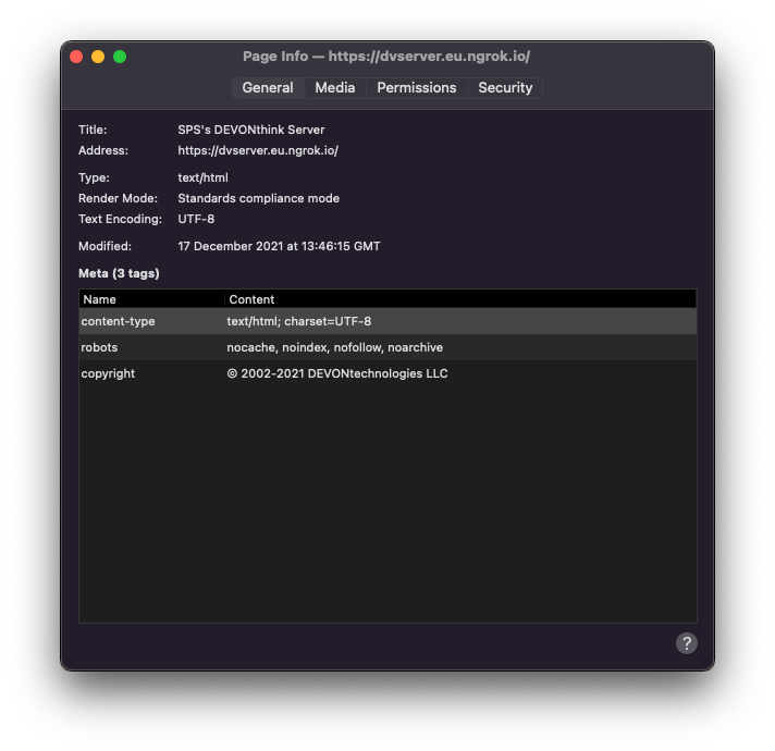

These are the secure page details;
Probably. But that’s a CSP issue, as I already said. Somehow, the server did not deliver the stylesheet with the correct MIME type. This could be related to SSL, in which case getting your own certificate would probably not make a difference.

The network view you posted is less helpful then the console tab in this context. I’m not even sure that the network tab would show errors.

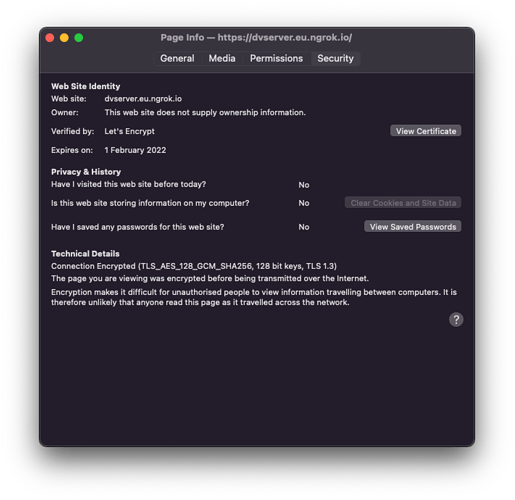

Also, there already seems a certificate issued for this domain as shown in the page information. You could check that by inspecting the certificate information by clicking on the lock in the address bar.

ngrok folks suggest the messages from the logs about the stylesheet are because the content type is wrong:
The stylesheet https://dvserver.eu.ngrok.io/app/css/app.lac68303.css was not loaded because its MIME type, “text/plain”, is not “text/css”

In one of your older posts (Web Server blank page - #47 by peter999) you posted a screenshot that clearly showed that two style sheets where not loaded by the browser because of a CSP violation. If the CSS is not loaded, the page may very well be blanc or completely broken or whatever.

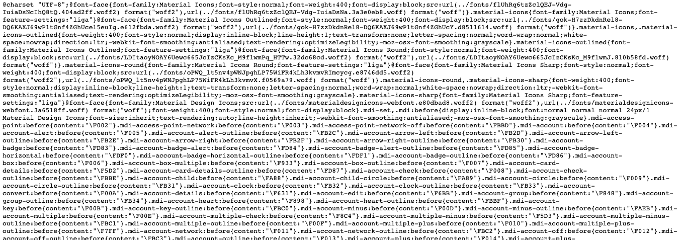

So it might be worth trying to load the CSS directly into the browser, i.e. by copy/pasting its URL (https://dvserver.eu.ngrok.io/app/css/app.1ac68303.css) into the browser’s address field. Does that work or does it give you a 404 error?

It does not work - only shows a very long page of code like this;

It does in fact work because this is the stylesheet. And that is what you get when you use the URL “https://dvserver.eu.ngrok…” from the outside, not from inside your local network?
Than we’re back at the original error message: the MIME type send by the server is not “text/css” (which it should be) but rather “text/plain”. This could be tackled in two ways:
  • make sure the server sends the correct MIME type. In an Apache webserver, that would be set in one of the config files, but I have no idea how DT server is handling that
  • alternatively, change the CSP for CSS files so that anything is allowed (which of course is not very secure, but should be ok for figuring out if that’s a possibility)

The next release will fix the MIME type.
