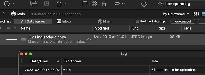

When starting sync, my desktop DT log keeps saying “Couldn’t upload 6 pending files, 6 files left to be uploaded”, but I can’t understand which ones and why (there are over 15000 files in my databases). It always mentions exactly 6 files. I’ve verified the database and the location successfully multiple times.

And the single pending item can’t be downloaded when clicking on download, and I don’t understand why it was removed from the DT desktop database (this particular group hasn’t been modified in years).
