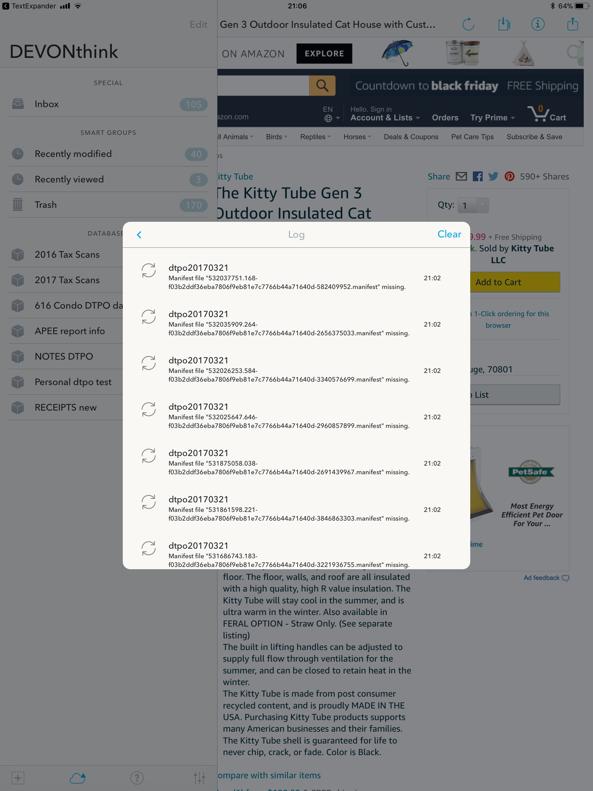

See attachment. What does this mean? Thanks.
Assuming that it’s not a temporary issue then the sync store might be damaged. Are you able to successfully verify the sync store on the Mac? What kind of cloud service do you use?
I use dropbox.
How do I verify the syncstore? I verify databases but don’t see a command to verify/check syncstore.
Select the Sync Location and press the Action menu (gear icon) or right-click it. If you hold the Option key, you can choose Verify Location Thoroughly.
Support ticket response indicated to clean from DTTG2. Trying that now.
@nishiazabu: Did it work?
How do I “clean from DTTG2”? Got the same manifest-message, thoroughly verifying didn’t help…
- Open DEVONthink To Go 2’s Settings > Sync : Edit Locations and left-swipe the location you want to clean.
- Touch the Clean link.
- Okay the prompt to Clean. This will remove Sync data from the location so you can Sync afresh. You should see a progress indicator noting the clean is running.
Jep, that helps - message disappeared on all devices (inclusive DTPO), thanx a lot!
It did not work in my case. I set up a fresh sync store and everything works now on 3 macs an ipad pro and an iphone.
