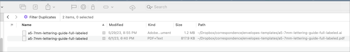

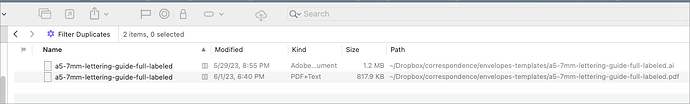

Here is an example of two files showing as dupes when they are not, with stricter checking enabled:
The other items being reported as duplicates of this file are no longer being displayed.
Is this also the case after importing these files into a new database?
Well, in fact a bunch of new, valid duplicates appeared when I used the Index Files and Folders item to add the folder to a new DT db. In the end, I removed the folder entirely from the original db, used an external tool to deal with duplicates, added it back, and things seem to be working as expected.
