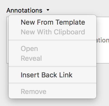

Thanks for your reply, as always. I’m confused about this ā€œnew annotation fileā€ function. Right now I’m using the Annotations & Reminders inspector, and here’s what I see when I click the downarrow there:
It doesn’t seem to have an option that references a file (other than the template, which is what I was trying to get at with my original question). Again, my apologies for being stupid here, but if you could just nudge me in the right direction to find the feature you’re talking about, I’ll be on my way…
It is a little confusing. The Help for Annotation & Reminders, under ā€œAnnotationsā€ says
New from Template: Click the down arrow and choose New from Template . This will create an annotation file, using the same template as the one from the Data meu, but the file will reside in an Annotations group at the root of the database.
but doesn’t explain what the ā€œone from the ā€˜Data’ menuā€ is. Out of the box, there is no ā€œannotationā€ template there.
Hmm. I tried to copy the Annotation.rtf file into the template directory, and restarted DT3, so that the Data menu’s New from Template list included Annotation. But then using the Annotation & Reminders inspector facility to create an annotation from template did not end up using that template.
I’ve solved the problem for now by simply replacing the template in the DT3 application resources directory. I know it’ll get overwritten when the next update comes along and that’s okay until a better solution comes along.
@mhucka: That is correct. That will not work that way. The dropdown uses the internal item (which I do not suggest you edit manually).

Ah, I think I understand now. If I add the old-style Annotation templatescript as indicated by @BLUEFROG (and kindly provided for downloading above), it works if I invoke it from DT3’s Data āžœ New from Template menu. Doing so creates an annotation on a document, and the annotation even appears in the Annotations & Reminders inspector. However, if I use the downarrow in the Annotations & Reminders inspector, this annotation template is not used (and its associated template script not used either, presumably).
This is fine from my perspective; in fact, being able to create a template and associated script this way is even preferrable because it provides more control over the way the Annotation is created and the keyboard shortcut assigned to it.
