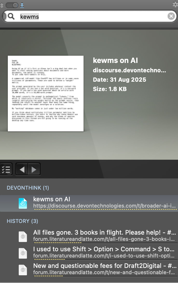

I did create a new DOCX Word file with only the words “Search test for Kewms”, and DEVONsphere did not find it. Curious. It did find a document in DEVONthink that was a forum post from you a while back that I saved. For me, could be “user error” or something.

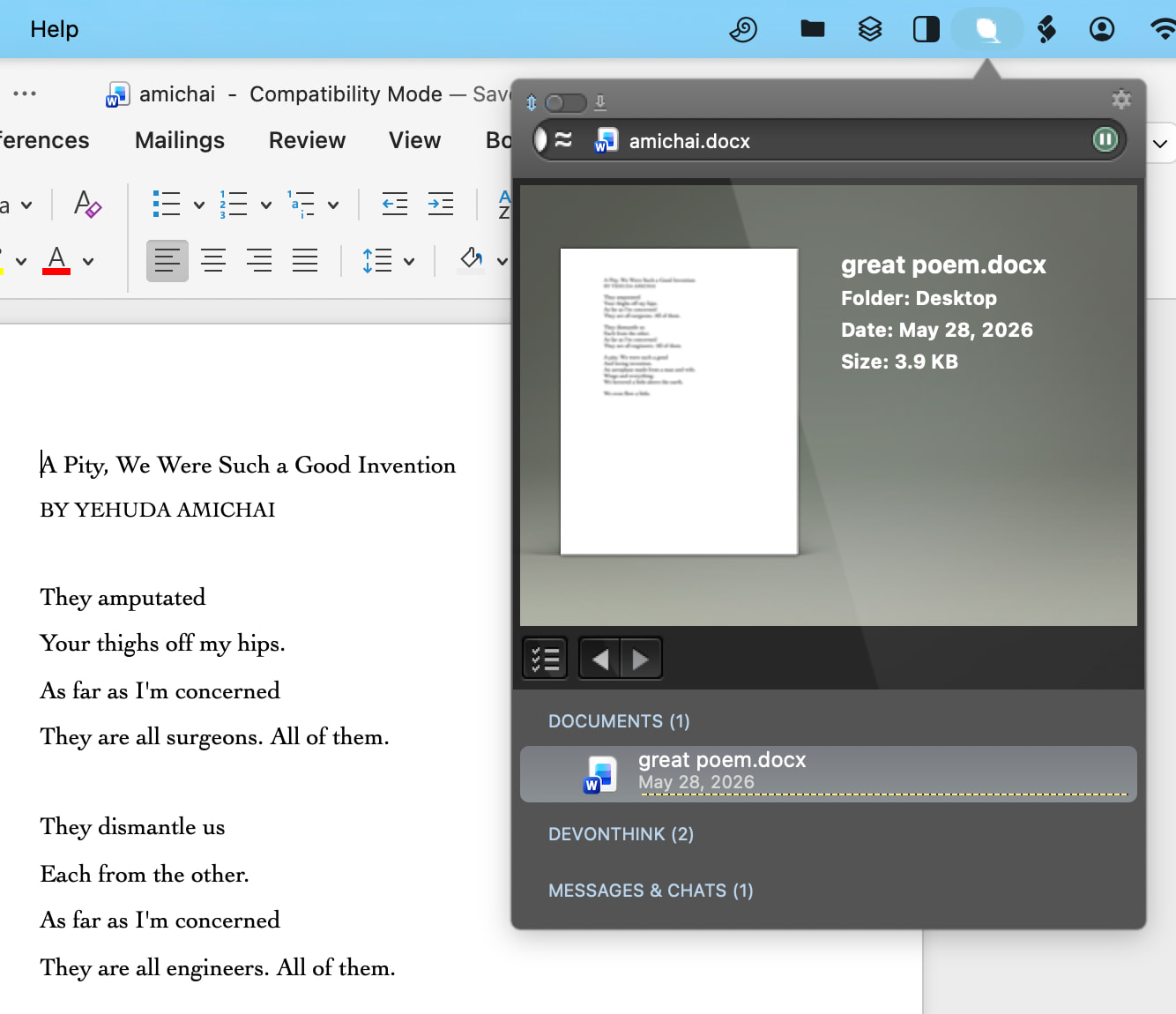

Word docs (.docx) produced in TextEdit with one minor difference between them. Saved to the desktop. DEVONsphere launched and index updated. Each document is detected by the other via See Also…

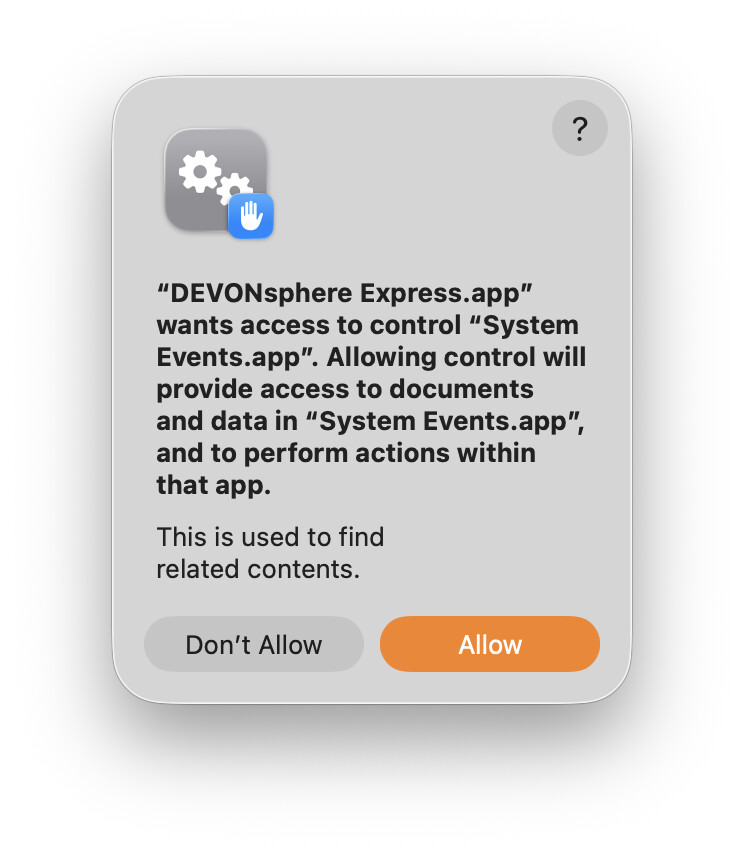

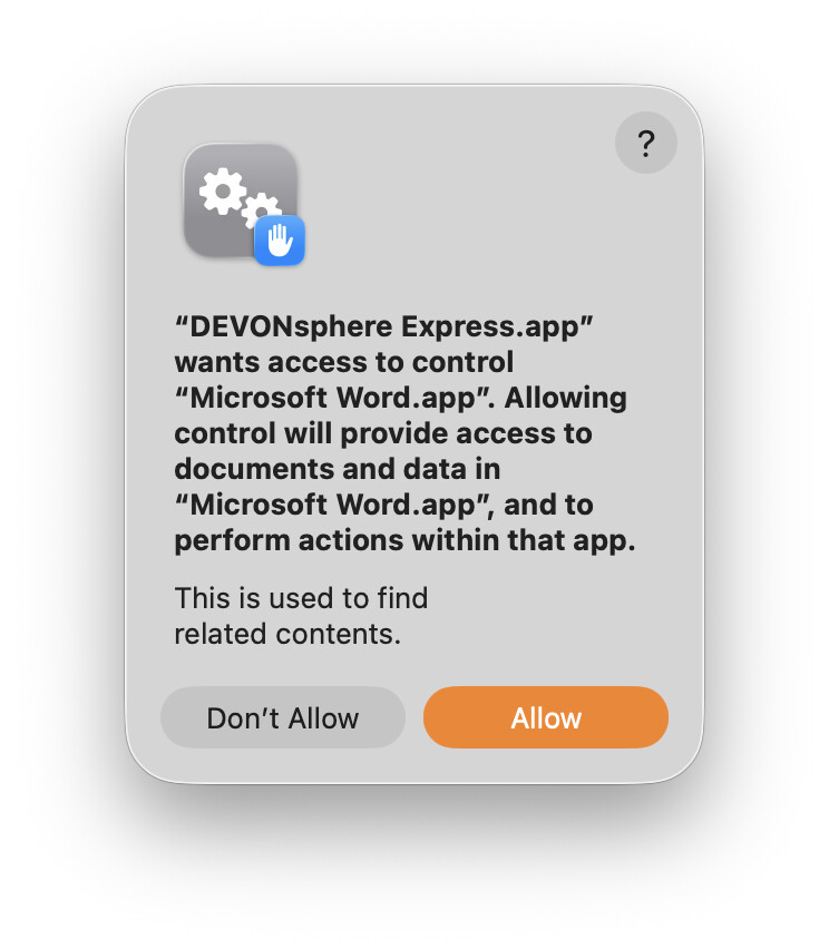

Note: DEVONsphere should have asked for Automation of Word and System Events at some point.
Perhaps you need a tccutil reset on it. Is this the first time you’ve been running it?
Ran it for a bit, de-installed because I didn’t find it useful, then reinstalled recently. So it’s possible that it has old preferences files lurking around.
I don’t remember whether it asked about Word specifically or not. Where would I look to see if those are enabled?
It should be in System Settings > Privacy & Security > Automation.
