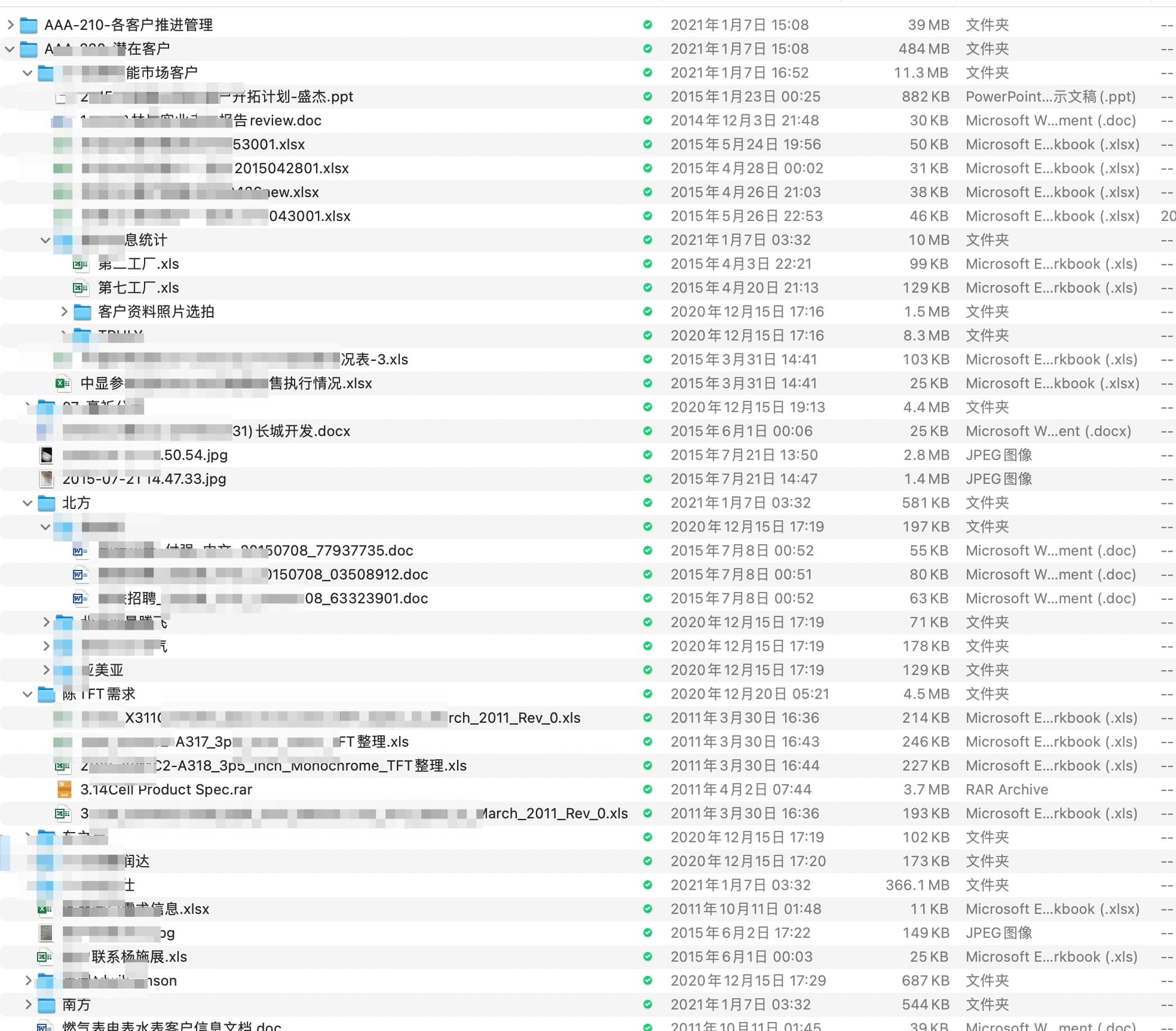

According to the below picture, you can see the rar file in my file folder ( there are many file type).

The number (484) folder an the number (13758) folder is place in the same folder.
