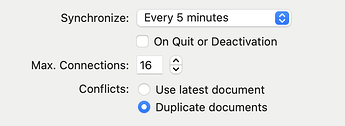

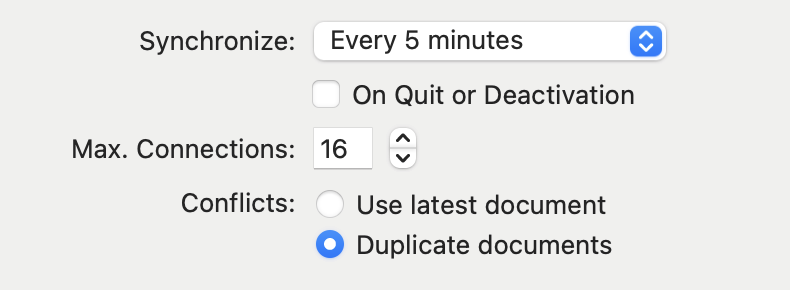

  • Is your sync interval set to Automatic ?
    • If so, set it to Every 5 Minutes and see if the behavior persists.
Yes, it was Automatic, and I’ve set it to 5 min, but the behaviour is the same … either clicking up or down arrow immediately autocompletes the wiki link,

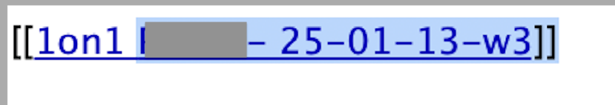

The work around it seems is:
  • when autocomplete is done the filename is selected after the Space, like on pic below
  • then I do 2 backspaces to delete the selected part and one space, and then continue typing till drop down list is presented and then in most cases I can use up/down arrow to go to wanted file name
On :backhand_index_pointing_up: picture is shown selected part of the file after pressing space. One backspce will delete the selected text in blue.

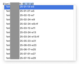

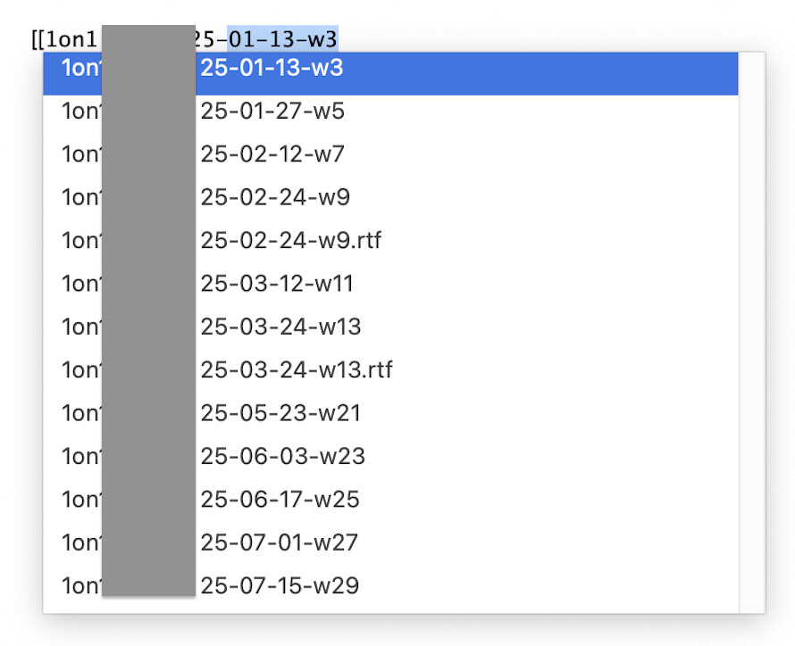

What I think the problem is, is the length of the list, as mentioned above, that is:
Here on below pic the list is long but the behaviour is ok, I can go up/down multiple times and I can select whatever file I want, no issues

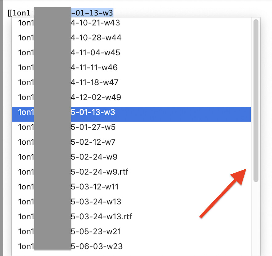

However below, the list is longer so there is slider as indicated by red arrow. Now this autocompletes in, I would say, uncontrolled manner. It just autocompletes sometimes after first up/down_arrow, sometimes, if I first use mouse to scroll a bit, and then use the up/down it will autocomplete after few up/down arrows.
However if you do the workaround described above, even if there’s slider, it behaves ok.
Hope this help
