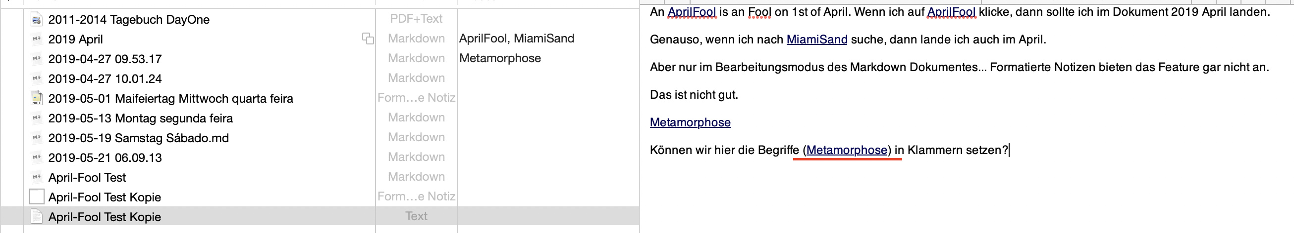

after reading this post I was experimenting with aliases and WikiLinks in DT2 and DT3. In DT3 the Aliases do not become links, when in Brackets. In DT2 this works. It ist only when using brackets. So writing (ArtificialIntelligence) in the text is not recognized, while “ArtificialIntelligence” is recognized.

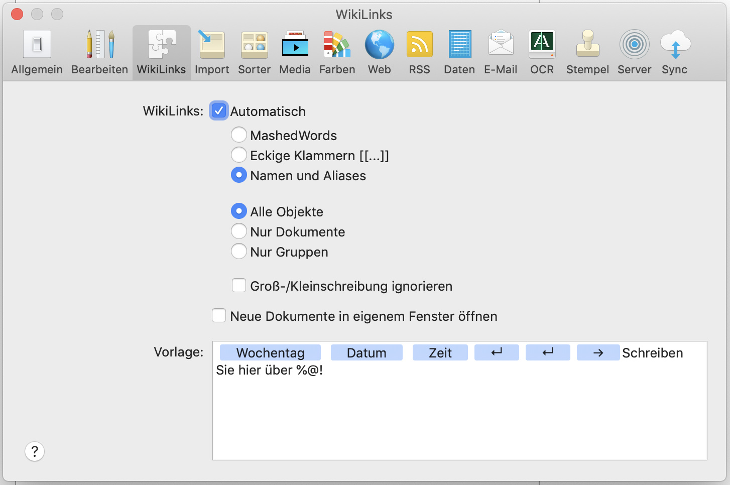

Maybe I have configured something wrong? Configuration ist attached below.
See Screenshots. The one about KünstlicheIntelligenz ist in DT3, the other in DT2.

OK, I understand the special character thing in markdown. DT2 shows the link in the markdown file when in edit mode. This link is working, but when in preview mode the link is not displayed anymore. You always have to switch to edit mode to show the link and to use it.
I have tried to escape the parentheses in my markdown file with a backslash, as mentioned in the markdown reference, but that doesn’t work, too. Maybe it’s possible to make links work when parentheses are escaped?
So if you write something like that \(AliasToFile\) the link ist working. Maybe @cgrunenberg can consider something like that for future releases.
