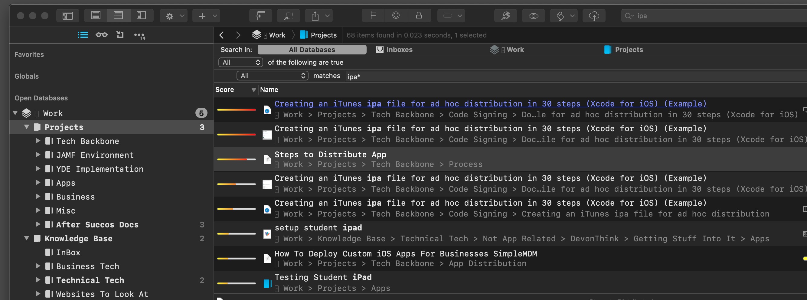

here is my workflow.
I am working here …
then I do a search for some info…
I would like to look at a file in the context of its location so I do a reveal
**Now I have no easy way to return to my previous work location context. Because I didn’t use the navigation pane to get to the exact subgroup originally. **
This is the current location. The Setting Up Students group has not become the location. It has merely been selected, and likely expanded.
If you had selected it in the Navgate sidebar or double-clicked to open it in the same window, it would be listed in the previous locations.
