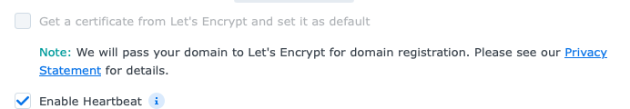

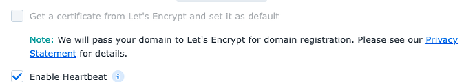

So if it helps anyone else with a Synology NAS: a Let’s Encrypt certificate can be issued from the window where you edit your DDNS (under External Devices in Control Panel) – mine is greyed out in the screenshot because it’s after the certificate was issued:

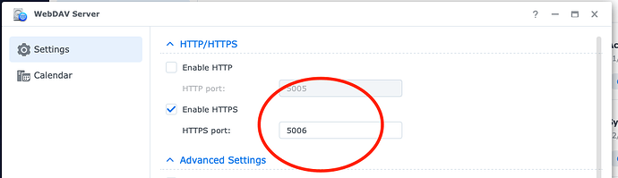

The port forwarding rule in the router was relatively simple, once you know that you need to have WebDAV Server installed on your Synology – you’ll be entering the number that you have under ‘https’ (assuming you want to use that, not http):
