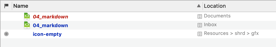

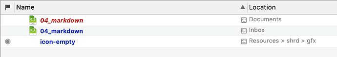

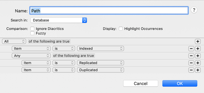

A Rebuild removes missing file references.
This would show indexed and duplicated/replicated items…
You could then show a Location column in the item list.
Does that help?

This sounds similar to the situation I just ran into. My database has a number of indexed group in it, linked to folders on an external hard drive. I had to replace that hard drive (cloning the data to a new drive), and for reasons, the new drive had a new name (although the data was the same). I hoped there was a way to review each indexed group and update the folder they pointed to, but there was no way to do this.
@BLUEFROG, that smart group works, but I found a couple limitations:
  • it would be useful to be able to limit the search to indexed groups from a specific hard drive (e.g. location contains “Volume/Harddrive1”).
  • It would be useful to be able to limit the search to the main “parent” folders that are being indexed, and ignore the content within.
Which is essentially the same as specifying a MacOS Finder path as search criteria in IMHO…

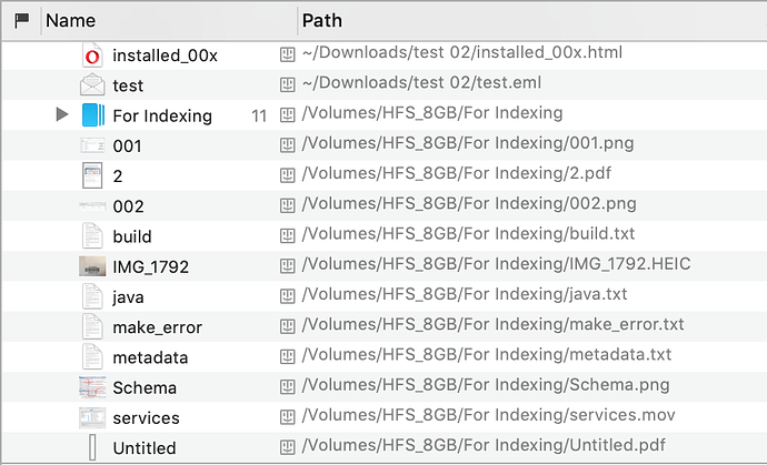

Do note there’s also a Path column you can sort on.
Ah… this is a feasible way for checking/matching files in folder vs items in group! I overlook this column option perhaps by automatically assuming that path is the same as location (which is not).
However, I just found out that location is “good” in just showing info down-to group level but path is “not so good” in showing the (very long) file name, too. Developers might consider to modify the path info to skip the file name, much similar to the format of “Location” col in DT or the format of “Where” in the “Show Inspector” of MacOS Finder. This will dramatically reduce the col width for sorting.
Indeed they are not synonymous.

Yep, that’s what I ended up using. It’d be handy if you could do a smart group based on contents of Path as well.
I suppose what I am suggesting is this: it’d be handy to be able to work with all of the folders you indexed — not the subfolders inside, but just the main folders that I added to my database. I’d love a simple way to see all of them, see their path, and then be able to reindex them, or assign them to a new location (in the case of switching harddrives). Does that make sense?
