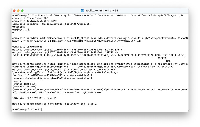

PS: Skim.app doesn’t modify the original PDF’s layers, instead writing the extended attributes of the file…
Whether this is a good approach or not depends on the situational needs but it’s certainly not portable across platforms and may even be stripped when put into a cloud-synced folder, e.g. , OneDrive. Testing would have to be done to determine such effects.

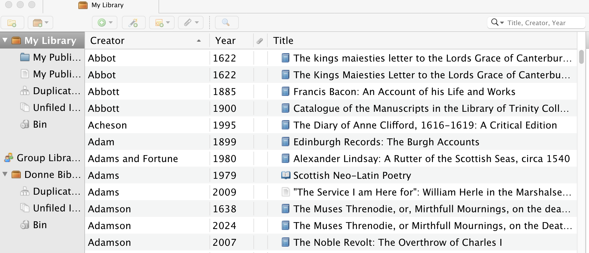

Fellow academic here! I have a simple setup using DT and Zotero. My trick? DT takes care of file storage, management, and searching etc. Zotero only contains the citation metadata that, as you’ve found out, DT is not well suited to collecting at the click of a button. DT is much, much more robust as a knowledge management system, but I love Zotero for the citation plugin with Word. For clarity – my Zotero database contains no PDFs at all.
This may seem cumbersome in that you end up downloading the citation + PDF to Zotero (often with the automated browser plugin), and then push the PDF to DT, but in truth that doesn’t take me much time. Nor do the odd times I need to manually add citation metadata.
The simplest setup, in my experience, is to avoid any roundtripping between the apps; avoid indexing of Zotero folders; etc. There is a little overhead, but nothing that’s getting in my way. Document management shared between DT3 and DTTG, and annotation on iPad with the Pencil, is out of this world – very robust, and very reliable for me. I sync via Dropbox.

Zotero to Word plugin doesn’t care if there are PDF or other attachments to its entries. As long as the metadata set is complete you are good to go. I’d run some test if I were you, mock up something to make sure it’s working for you.
But you are right, if you manually move a PDF that is added there by Zotero, you won’t be able to open that file anymore from within the app since it has lost track of the location.
But as you can see from my library, I just have no attachments (nothing marked under the paperclip symbol). Works just fine in Word!
