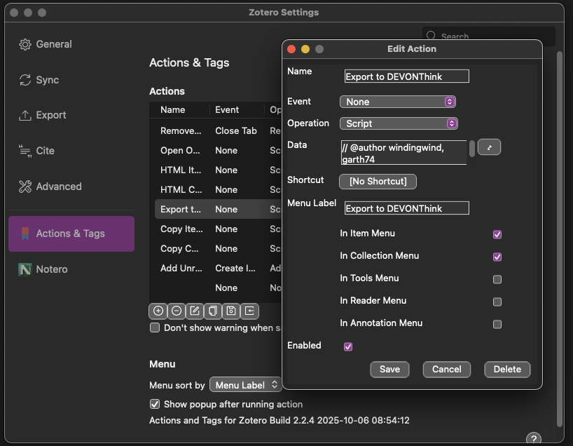

For this version to work you need to first install the “Actions and Tags” Zotero plugion:
Then you install my Devonthink-Zotero-API as an action within the Actions/Tags plugin:

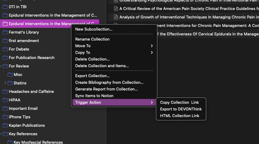

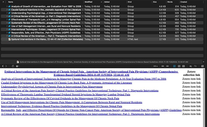

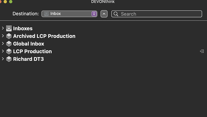

Once it is installed - within Zotero you can right-click on a collection and choose “Export to Devonthink”

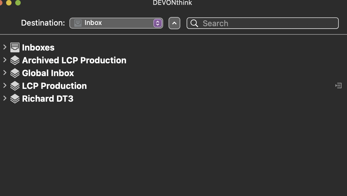

That brings up the standard Devonthink group selector:

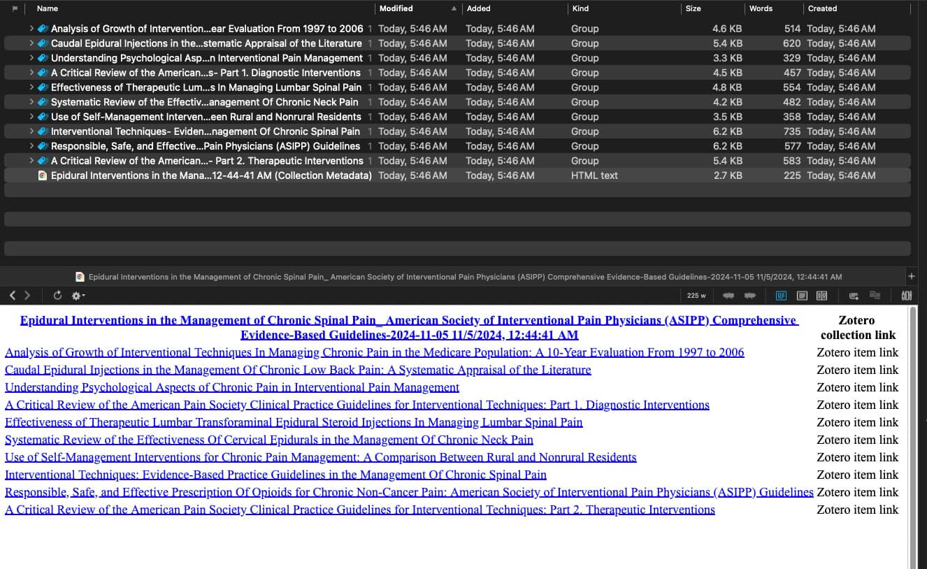

That will create a Devonthink subgroup in the destination of choice which contains each of the Zotero entries with its notes and underlying documents as welll as an HTML summary containing Zotero item links to get you back to the item in Zotero:

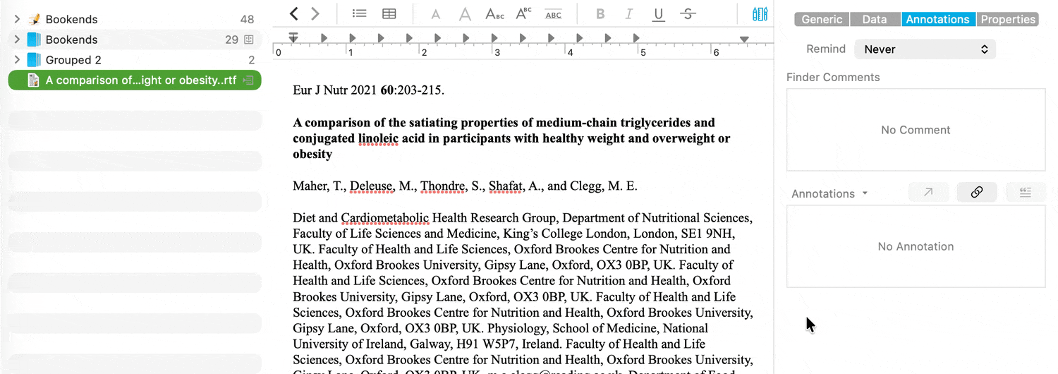

I’m curious if you’ve considered using an annotation file instead of manually creating a Markdown note ? It takes the name of the referring document and automatically has a backlink (when using a default built-in annotation template)..

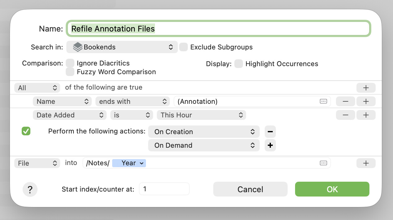

Here is a simple smart rule that refiles an annotation file after it’s created.
And the result (and yes, it happens very quickly)…
refile-annotation-files

Thanks Bluefrog - I have now completely adopted the annotation file for my workflow.
I use the smart rule to separate my Annotation files from my PDF’s and keep my reference database clean, and really love the linkages between them. So convenient!
