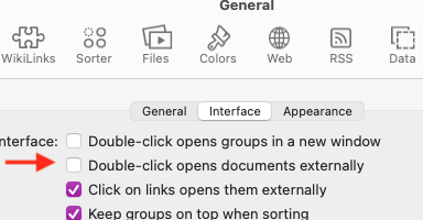

You can also control the behaviour of double-clicking on the item in DT3. If ā€œDouble-click opens documents externallyā€ is not selected (see image below), then double-clicking will open the email in DT3’s wrapper. If it is selected, then it will open the original email in Mail.app.
Note the keyboard shortcuts above are not affected by this preference selection.

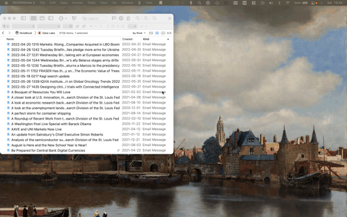

Hmmm…I’ve created a .gif animation from a screen recording of me selecting an email stored in DT3, then pressing CMD-SHIFT-o.
You can see the original mail in Mail.app (check the menu bar) open next to it.
Apologies for the tiny GIF. It’s a limitation of the software I am using for the conversion.
CMD-SHIFT-o.mov
