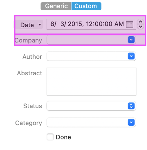

But there’s nothing in the company field, which should come from the "source: " area of the markdown doc. Dates fine, company is blank.
Can anyone give it a once over? Thank you!
How exactly should it come from there? You use source to set the “Author” field, but you do nothing (at least not that I can see) to set the company field. DT might provide some AI, but I doubt that it goes this far.
That’s fair, I had the wrong field selected. So I fixed it, and nothing shows in company still after running the rule. I’m curious if I’m getting the concept right, because it’s not working and I’m not sure what I’m doing wrong other than confusing posting.
It seems that the company is a list field. It should probably be a text field. See your definition of company in the custom meta data.
Thank you for looking, @chrillek. Unfortunately it’s single-line text. I think that’s just a string. I feel like I need to RTFM but I did. I feel like I need to R_a_different_FM. Anyone got a suggestion?
I suppose that ‘Scan Text’ does not consider the Markdown meta data. But @cgrunenberg would know about that.
That the ‘Date’ is set in your example is obvious, because you’re using the document date, not the date in the meta data section.
That’s right unless the hidden preference IndexRawMarkdownSource was used to import/index the document.

It’s still reading the second date in the file as document date. Is this expected behavior? While I’m here - I don’t need to be fancy about markdown, is there a better format for a group of text with metadata into DevonThink?
document date does not necessarily return the first date.
