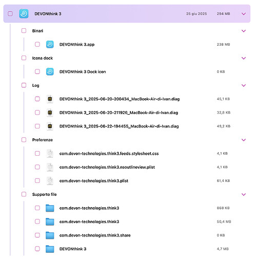

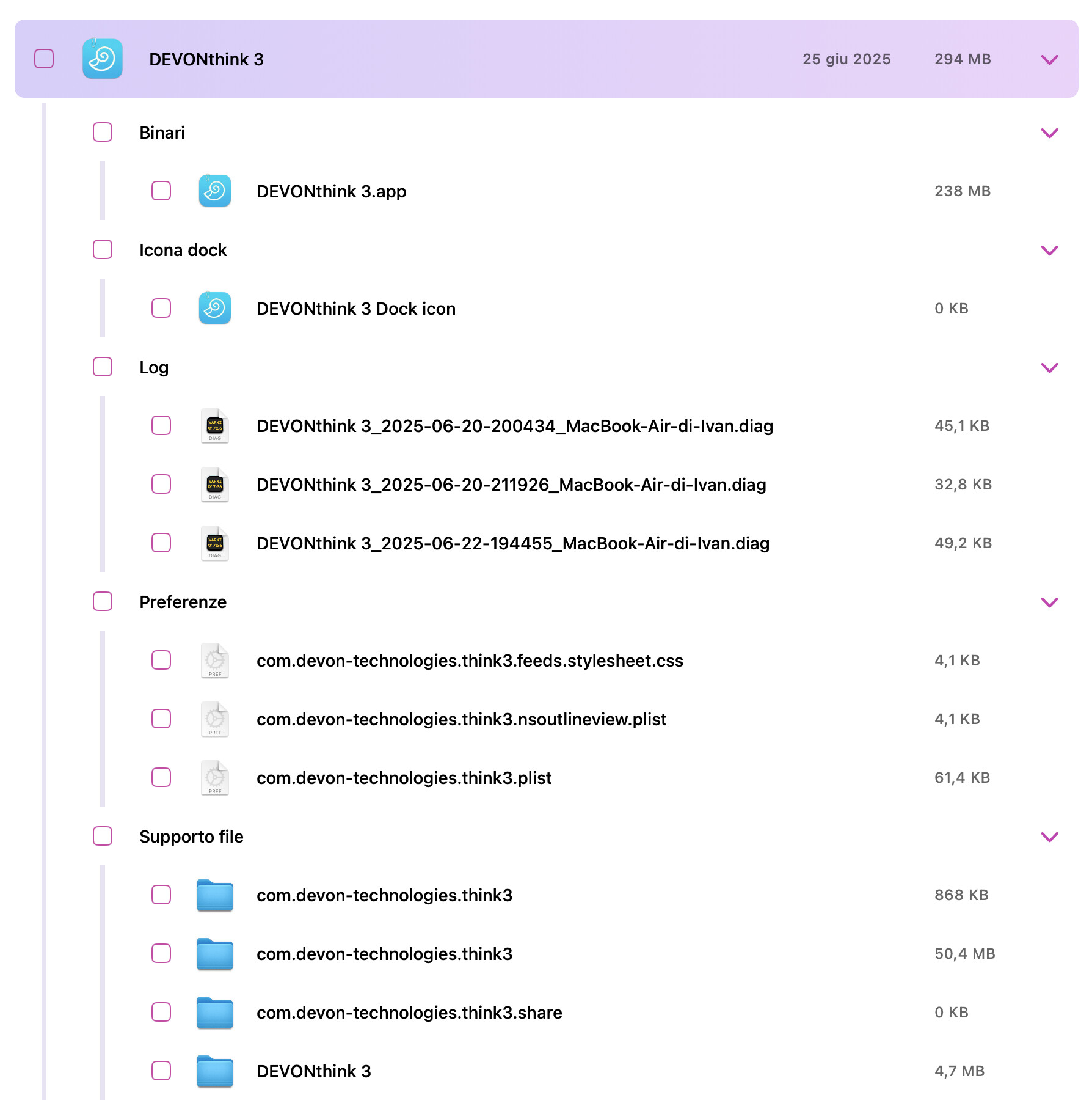

(I ask here in order to avoid a fresh new, but redundant, thread)
I’ve upgraded to DT4, now I want to uninstall DT3: what’s the best practice in order to completely uninstall DT3 without corrupting DT4?
CleanMyMac finds these file to remove:
Can I proceed?
Are there other files left to remove?
TNX!

We do not recommend using an uninstaller application. If you want instructions on a deep cleaning of DEVONthink 3 resources, open a support ticket.
I would not use tools like that. You don’t know if they really remove everything that is no longer needed. Nor do you know if they perhaps something that might still be needed. And I’m not talking about the app folder itself (‘DEVONthink 3.app’), but about all the other stuff. Most of that is insignificant size-wise, so what’s the point?
Aside: I would certainly not use a tool that purports to clean up something and then asks me if I agree with what it wants to delete. How would I know about that? What they do here is to simply shift responsibility for any mishaps onto the user.
