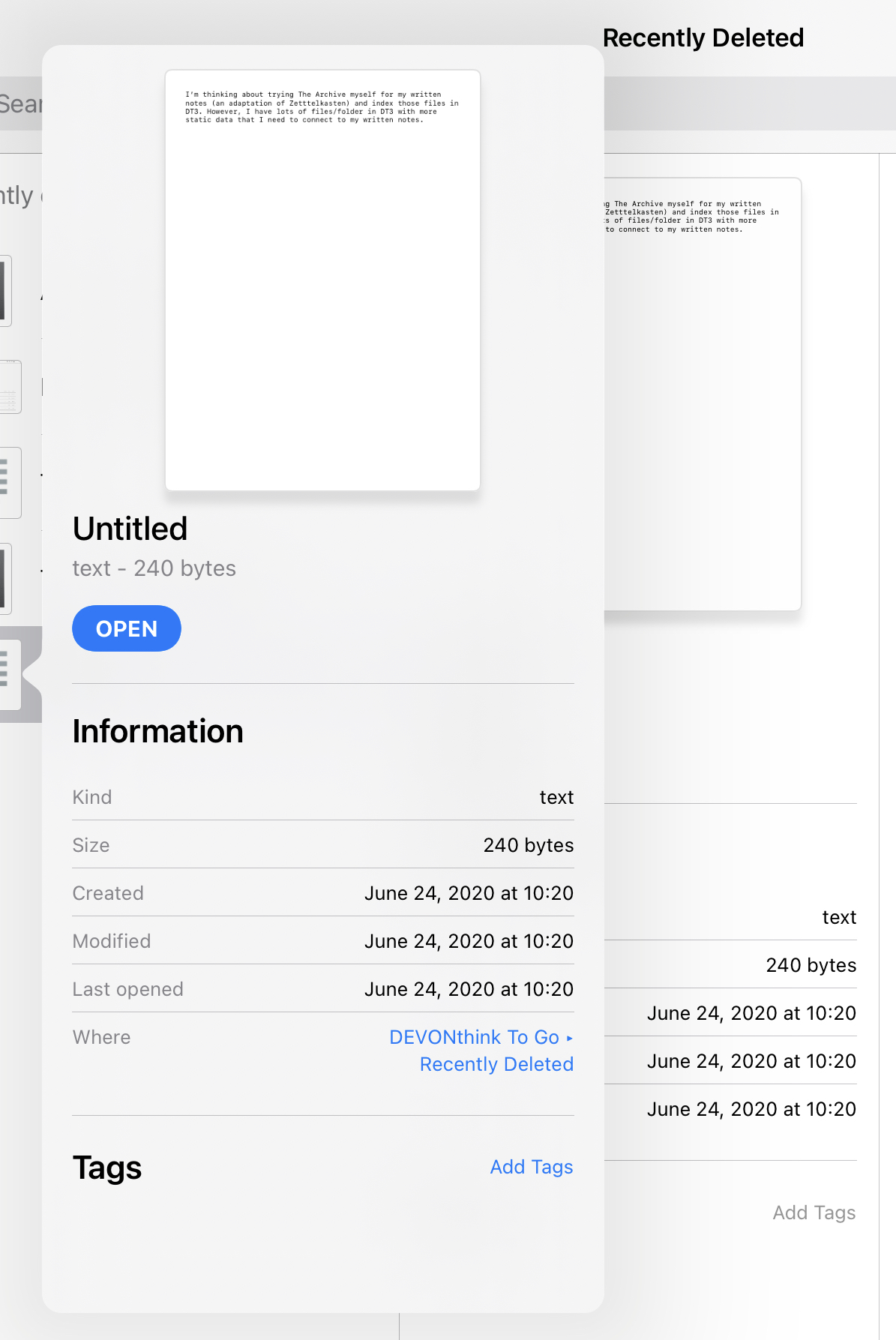

If the document had a thumbnail, then yes that is still visible. You can see that in the image I posted above, I can see that the last document in the list is a plain text file with 3 lines of text.

No, tapping it doesn’t do anything with the document, but the full preview of the first page is visible, and readable, in the thumbnail that shows in the Info pane.

The security risk is not limited if the documents are small, plain text files, as is not uncommon for me as I take a lot of plain text notes that are no longer than a page. The entire text of said documents is viewable in the document thumbnail, even though the document itself cannot be opened. I just captured this image today.
