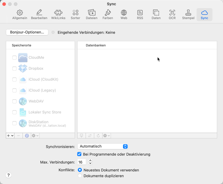

These are the steps:
I created a new folder remotely “Backup2”.
Then I opened settings, Sync.
I have used the lower left pull down “+” , then add local sync store (can’t screenshot the pulldown window).
Then I browser to the location. Unfortunately DT doesn’t even accept keyboard inputs on the file name, so I use “ohne Titel” as predefined.
Then a new sync store appeared and I checked both active databases to sync.
After finishing the setup, nothing happens. Remote location file size is still 0.
Action Window shows no actions.
Try file-synchronize all. Noch nicht syncronisiert should disappear.

Yes folder is on NAS. NAS is a Synology DS916+ .
Or, close the databases. With Automatisch selected, they should synchronize on close.
