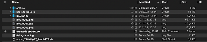

And then I tested again:

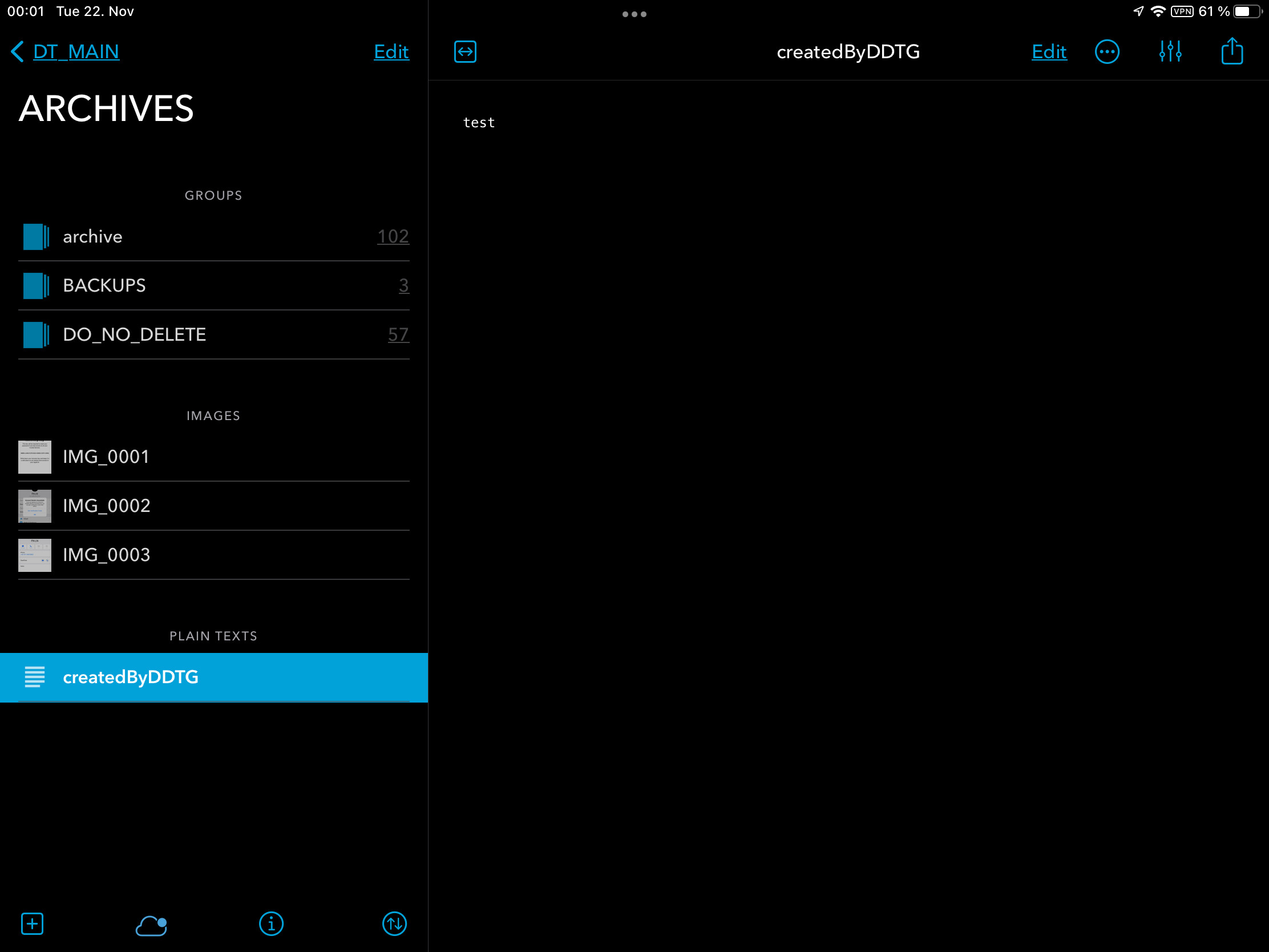

Created a new text file from DTTG in the above …/ARCHIVE group:
It got uploaded to WebDAV and … bammmm… it also showed up fine in DT:
So, the problem only exists for certain file types, but not for others.
Very strange.
But DT can indeed download new files from WebDAV and write them to the indexed folders - just not for every content.

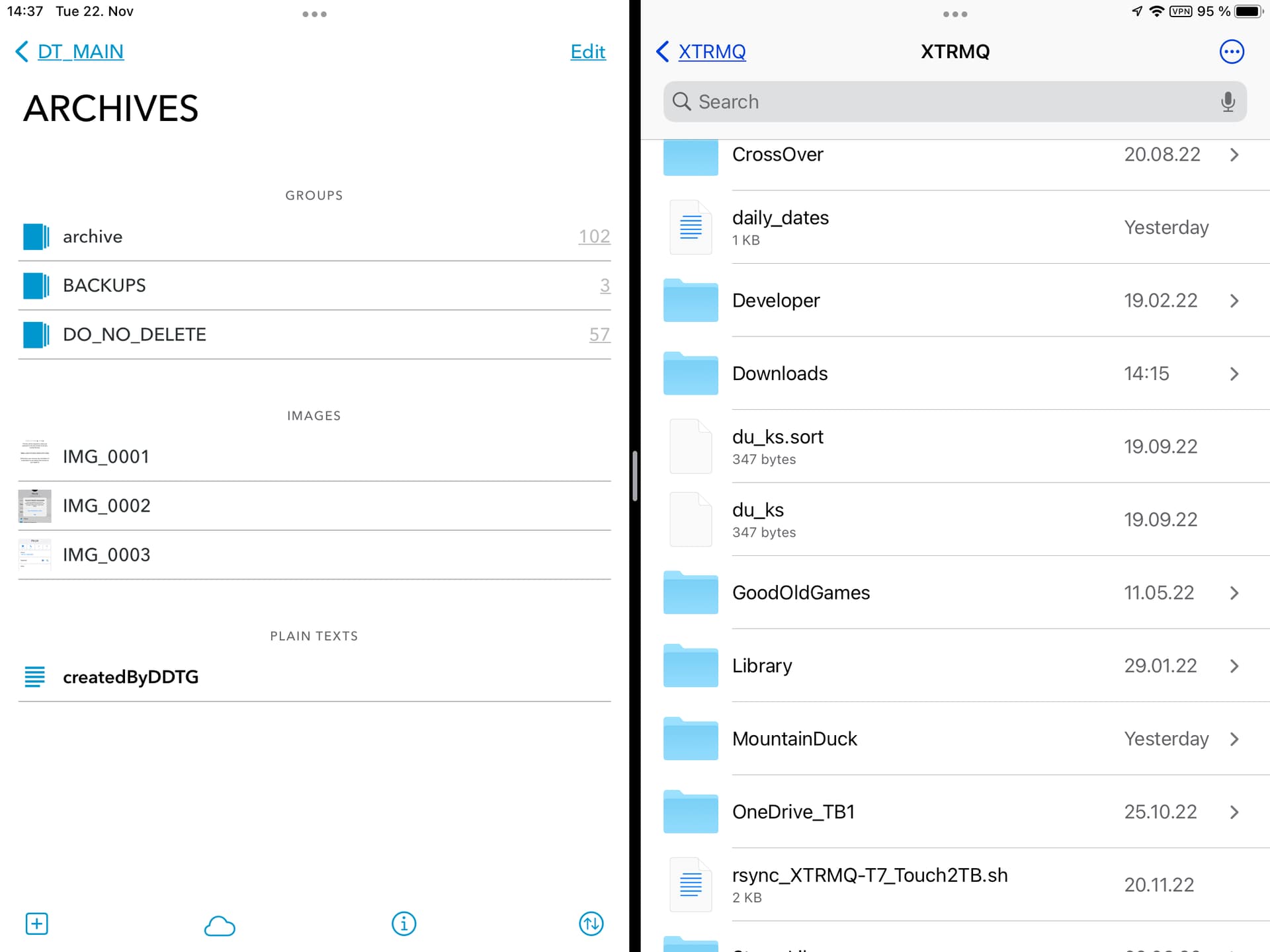

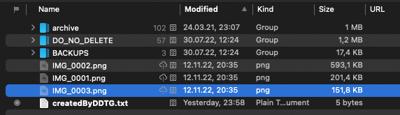

Also, to show this again, I added 2 more files to DTTG:
So, they got added on iPad…

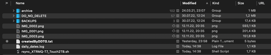

And then, looking on DT:
They appeared without problem!
But NOT the PNG files…
