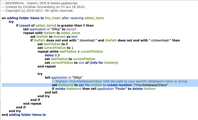

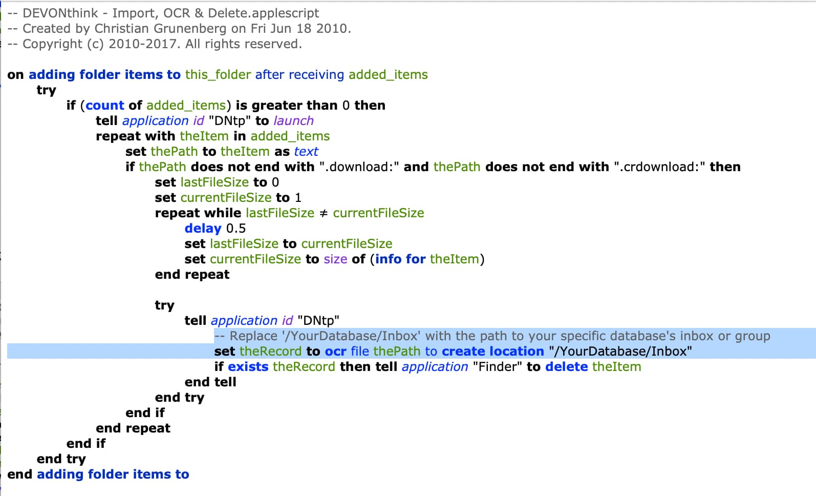

I would now like them to end up directly in the database-specific inbox of the respective user instead. So all scans from NAS folder A end up in Inbox A, all scans from NAS folder B end up in Inbox B. This probably requires the specific storage location to be integrated into the script, i.e. the script must be adapted accordingly. However, I have not yet succeeded in doing this.

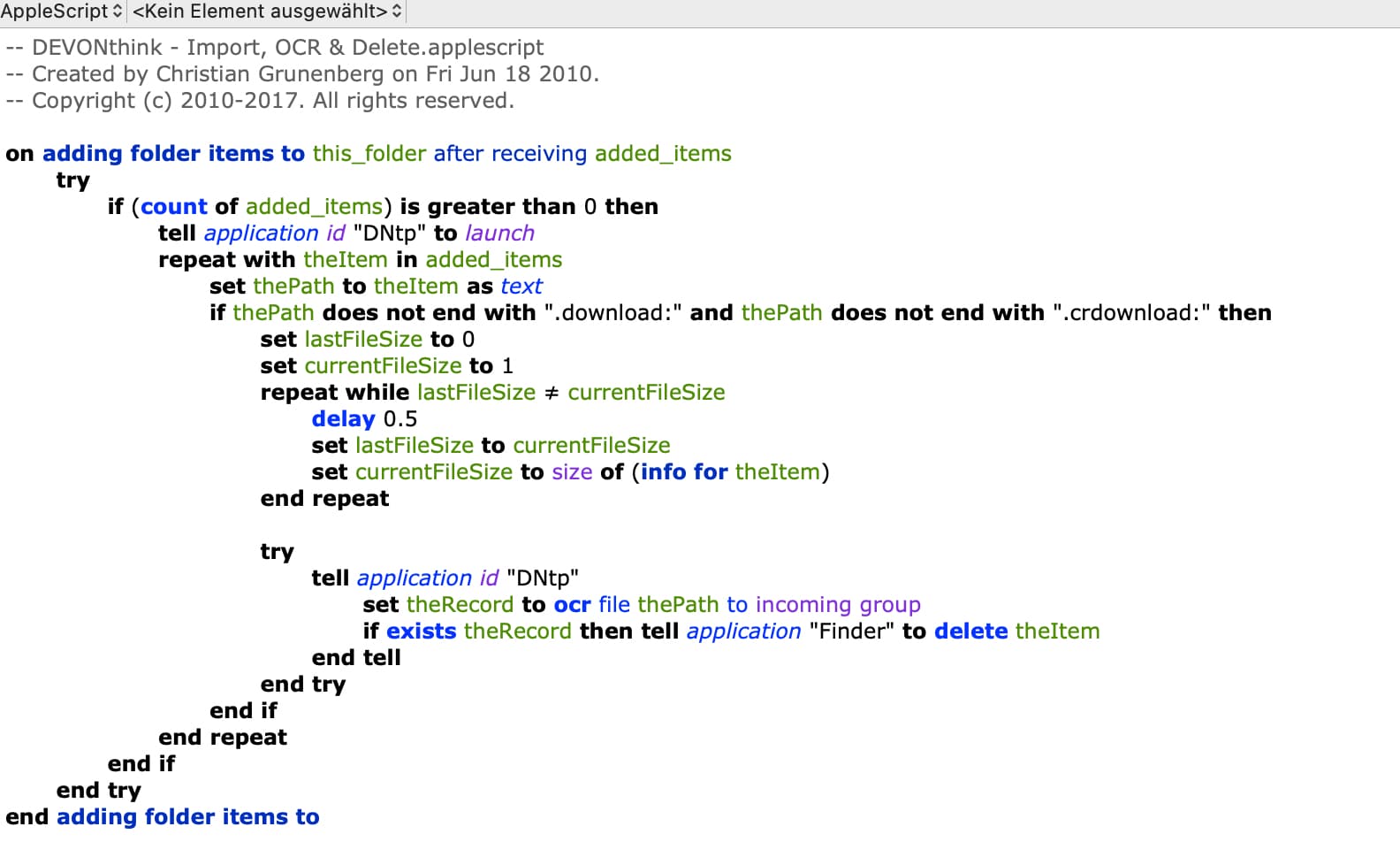

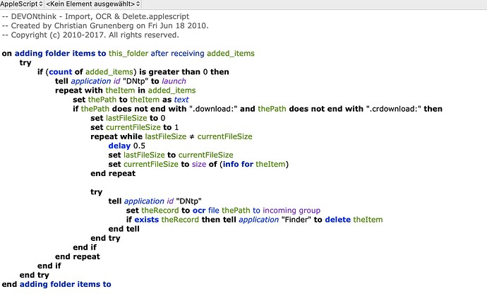

I would appreciate any tips on what exactly I need to change in the script. The script looks like this by default:
My customised script is not working and needs to be modified to make it work.

While that might be true, it doesn’t tell anybody anything. Not working can mean:
it doesn’t do anything
it does something you don’t want
it does something you want but not everything.
Therefore, a detailed description is needed so that others understand what you are seeing or not seeing or wanting to see.
Code can be posted as text by including it in three backquotes like so:
``` code goes here

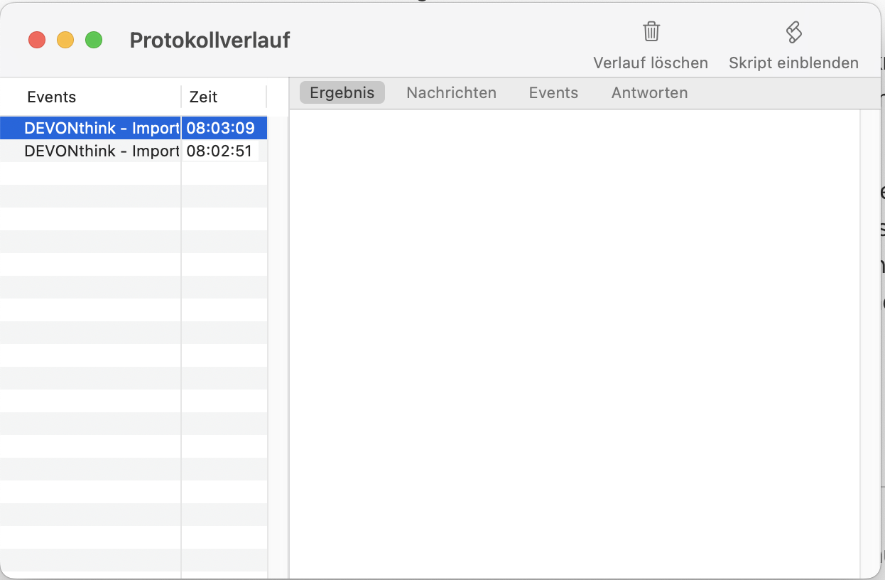

And try running your code in Script Editor. There, you can follow easily which steps are executed and what the result of each step is.

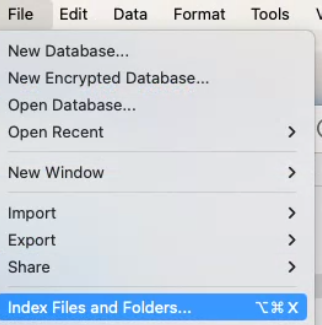

Then there’s the manual that explains the difference between indexing and importing. And a bunch of posts here discussing that. I still think indexing the relevant NAS folders into DT and using smart rule(s) that move(s) new files into the desired database location is a simpler solution – folder actions are a bit out of fashion.

By “not working” I meant that DEVONThink does nothing when running the code in question, while the default code works perfectly. There is no error message in DEVONThink or Script Editor. Since it is likely that only one line of code is affected, hopefully the problem is not too difficult.
I am explicitly looking for a solution with the “Folder Action” mechanism. The mechanism with Indexing & Smart Rule is known to me, I implemented it 2 years ago and it basically works, but unfortunately the reliability is not 100% and the solution does not seem to be the best in terms of elegance, because it only checks every minute if a new file has been scanned, and not directly on receipt. I’ll see which of the two solutions works better in practice.
If script editor doesn’t see an error, how would I? Also, I suggested to look at the trace of your script in script editor. Did you do that? What did it tell you about the line in question?
And why do you try to create a location in the database that’s there by default instead of using incoming group, perhaps like so: set targetGroup to incoming group of databases["yourDatabase"]
(I don’t speak AppleScript, so that’s only a vague approximation)
Also, why bother with (re-) defining the target group for OCR in each iteration instead of setting it as a constant for once before the initial repeat?
