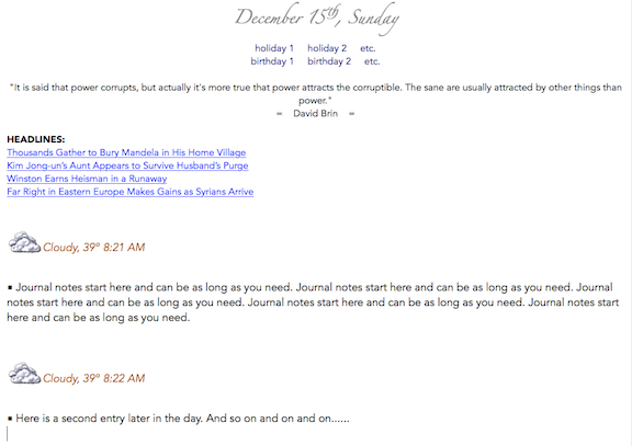

Here is a screenshot of the output:

		If the group heirarchy 'Journal/Year/Year-Month' doesn't exist, it's created.
		 Creates file in the form of 'month_day_year_weekday' such as '10_13_2013_Sun'.
		 A header with the date, holidays/birthdays, a random quote, and the current weather and time.
		If the file already exists , then no new file will be created and a new header will be added to the existing file consisting of the current weather and time.
