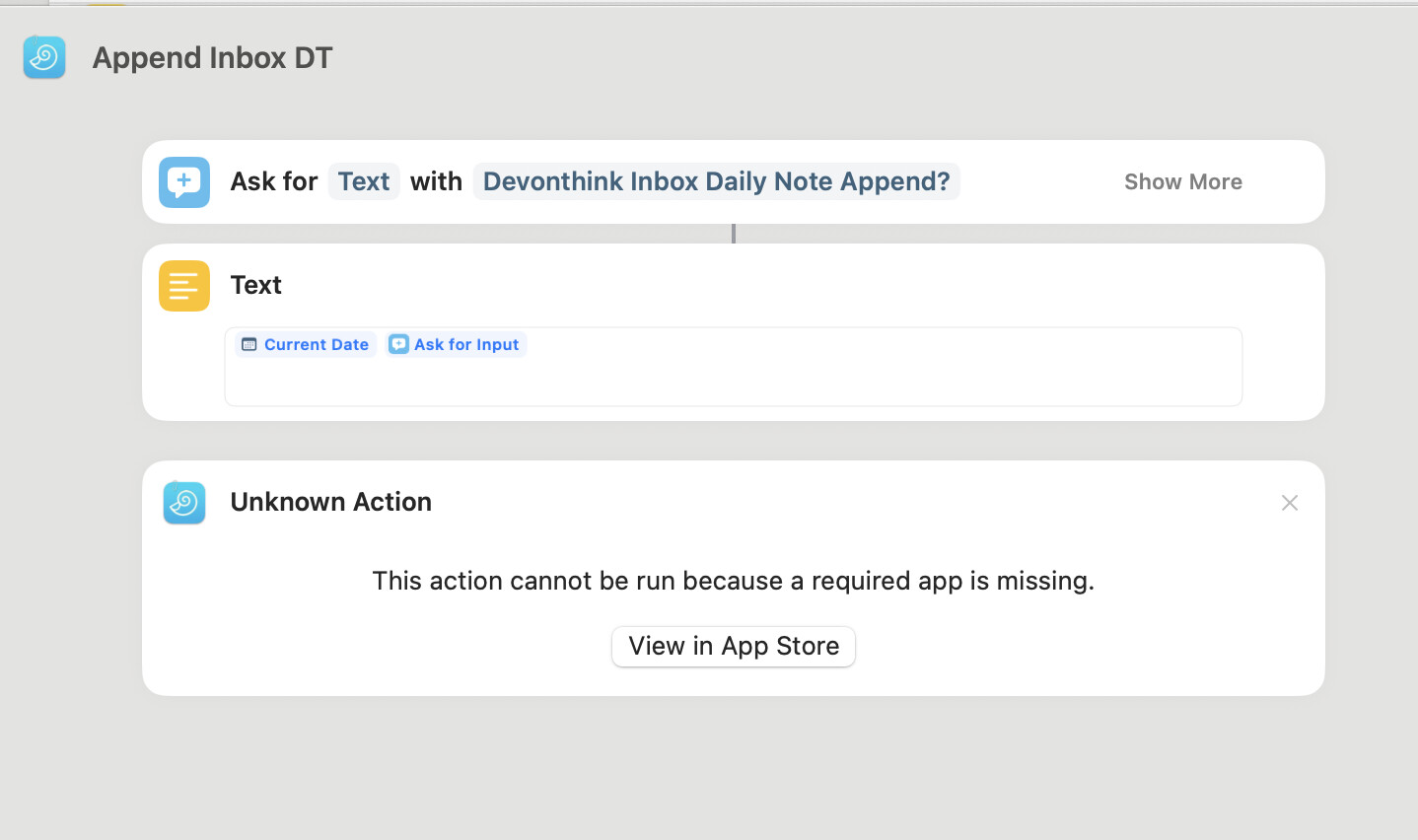

I am on DT 4b3; is there a way to use the same (almost the same…) Shortcut from DTTG on the Mac? for instance…

DEVONthink on the Mac doesn’t support Shortcuts (yet). The only workaround currently is to use scripts in Shortcuts instead.

what I wanted to do is to mimic a Mac script in a DTTG action; for instance how to “translate” into ShortcutsApp this:
