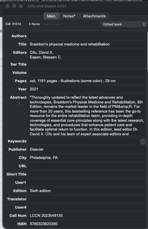

I would recommend using Bookends which is built with the primary job to do exactly what you are asking.
Then integrate that with Devonthink using Claude Cowork or similar since both Bookends and Devonthink have well-done MCP servers.
Best of both worlds.
With Bookends I just did this search:
And it came right back with:

“With Bookends”? Do you mean you entered that search into BE or that you entered it into DThink? And if DThink, your search was from “Quick Add” instead of the search bar?
In my mental picture, I would have this library in my DThink database, perhaps imported from Bookends as that’s the easiest way to enter/aggregate all the book details.
But is it, rather, that DThink merely goes out and grabs the info from Bookends? And as Bookends is a web based app, anytime I’m offline I will not be able to access that Bookends information?
