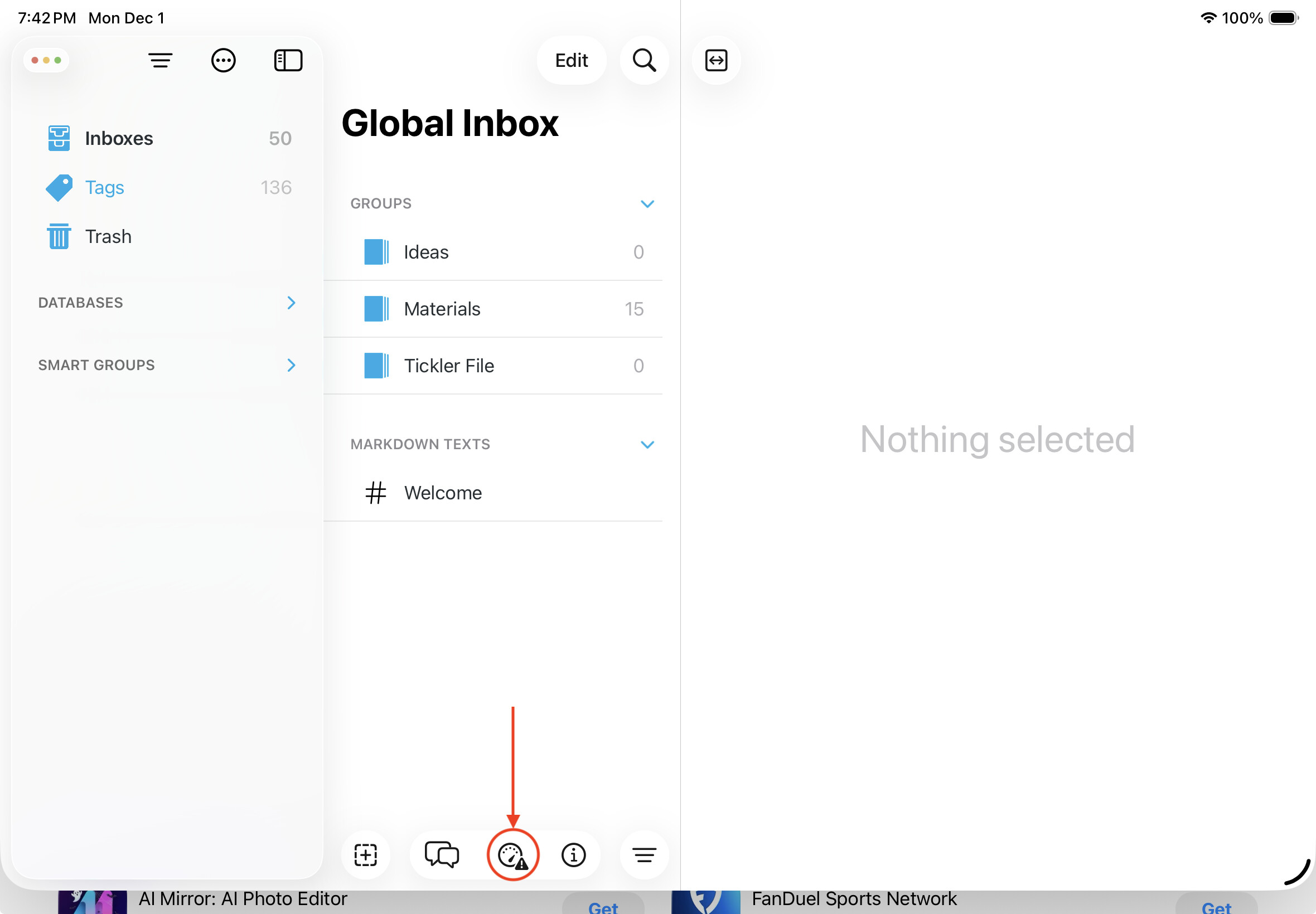

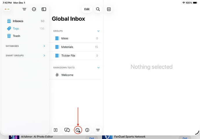

Is there a warning triangle on the activity icon in the bottom toolbar?
Bottom toolbar where. I have three panes visible and no warning triangle in any of them. In the first pane I select the icon with tree dots and select sync. Nothing happens
At the bottom of the item list…
I restarted the device and yes now there is a warning triangle in the bottom toolbar in the middle pane. I still can verify thoroughly just fine but no sync.
