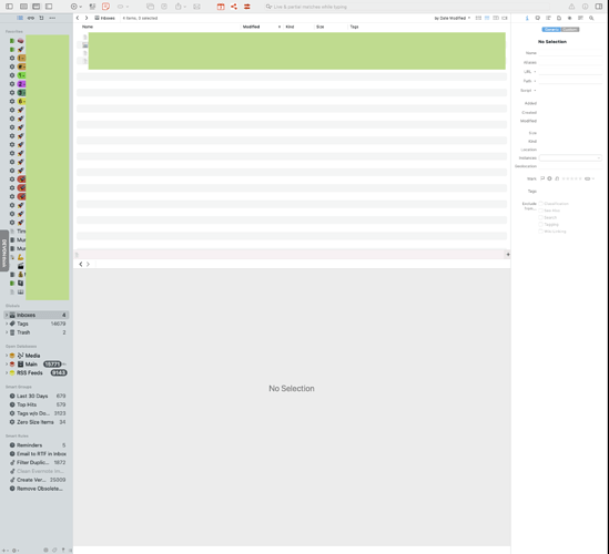

Hi, since a few days I’m having this problem on my iMac and on my MacBook Air 13". The DEVONthink window is not displayed correctly, a little bit on the top is not visible. It’s easier to explain if you look a the screenshot. The problem is I can’t click on certain areas anymore like toggle in the information panel, am not able to sort by name or whatever etc.
Anyone else having this problem? It doesn’t change if I switch to full screen mode etc. I am using DT 3 Pro 3.8.

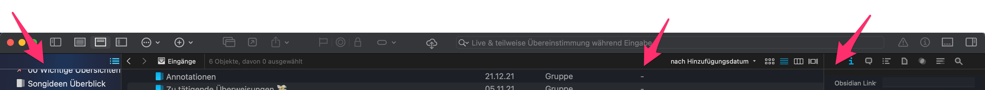

Typical example for this:
:slight_smile:
Did you have windows in fullscreen when you updated to 3.8.2, which quit and relaunched DEVONthink?
@cgrunenberg: I had a window open in fullscreen (several actually) and this is what I saw immediately after updating DEVONthink…
yes, this is exactly the behaviour I am talking about…and, yes, I did have the DT window open in full screen when updating. shared full screen (with another app) to be precise…and I am seeing this behaviour frequently (unless I want to show it … :wink: …)
