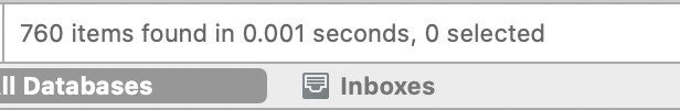

  7. When I do searches in DT, it never tells me how many documents has found. This is so annoying.

7. DEVONthink absolutely does report the number of found items.

7.Hi! You are right, I can see that I missed where items are found.
