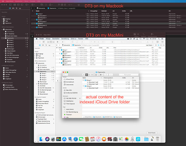

When I ran my proof of concept I quickly ended up with a folder convoluted with duplicates of documents and folders:
I think iCloud must be the problem maker here since when I was indexing a “regular” folder outside of iCloud everything worked just fine. I’d just like to know:

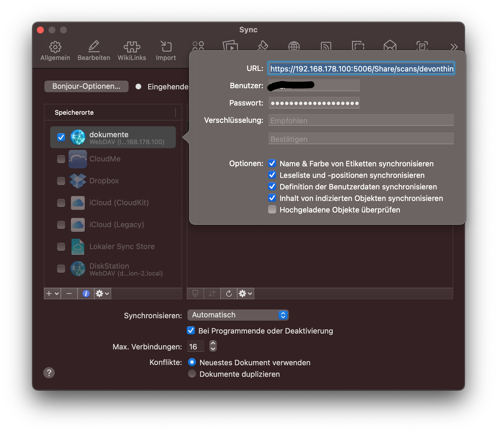

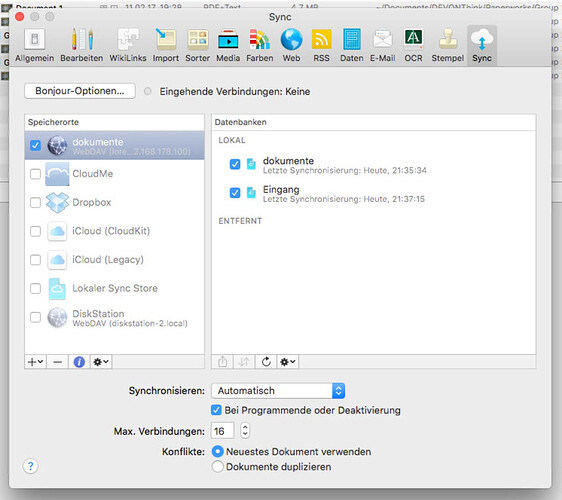

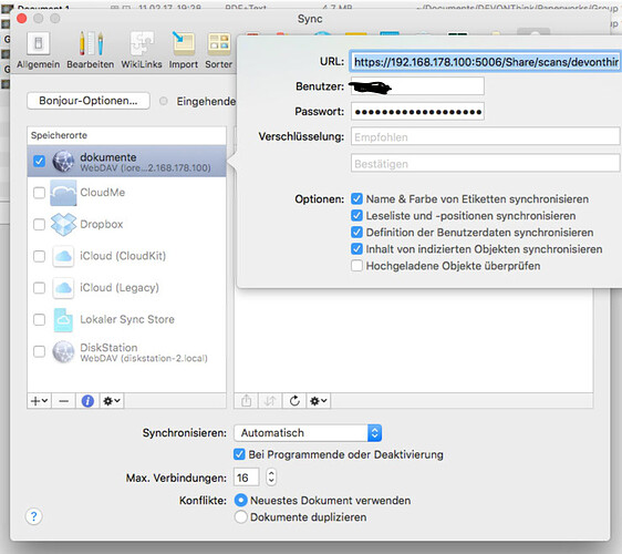

Now, I saw other people reporting similar issues, so I made sure it’s set to “keep the last document” - here’s my sync config:
Same goes for the Mac Mini:

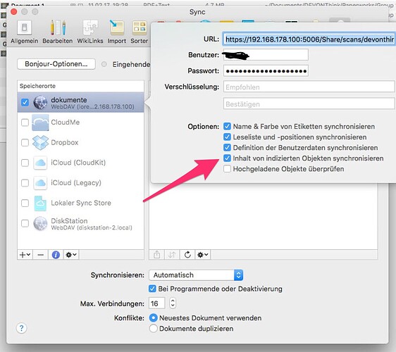

Hi,
when I tried this some versions of DT ago (maybe the Version 2 - DTPO) I had the same result. But when now un-selecting the sync of index file contents (screenshot) in the sync store settings before adding the database for syncing everything works as expected, at least for me on an iCloud sync store.
