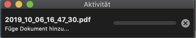

Same issue with SnapScan and DT3 on my side. The Activity Windows stays open and no PDF ist imported. Workaround with disabling/re-enabling in OCR section didn’t work
45
What are your profile settings in ScanSnap Home?
