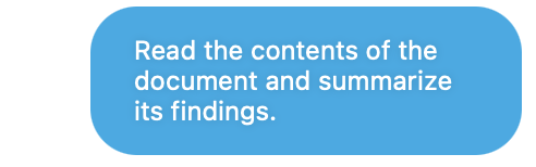

I think it helps to tell gemini to “read the contents of the document” before asking questions. Once I gave it that specific instruction, I could then prompt questions on it. I guess various chatbot GUIs do this step for you when attaching docs to a chat.
