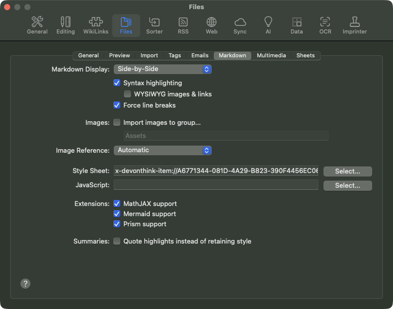

Just today, I had the same issue and can confirm that from all the approaches discussed in this thread, only the “Syntax highlighting” setting in DT’s settings → Files → Markdown has an influence on the problem.
I am observing this on macOS Sequoia, DT Pro 4.1.1. The document I am editing is a Markdown document that I created from the sorter. In terms of Markdown features, it only contains headings, links and bulleted lists. In order for the problem to appear, you need to create more text than fits into the edit window. Some lorem ipsum is sufficient.
My DT settings:
System-wide, my Scrollbars are set to “always” be visible.
The jumping effect is independent of other settings, including fonts and display settings from the “Editing” → “Format” dialog. Also, only changing “WYSIWYG-images and links” while keeping “Syntax Highlighting” active does not remedy the issue.
Typewriter-like scrolling does not affect the issue.
I can also observe the problem when scrolling into the middle of longer Markdown texts and type there – the scrollbar of the document visibly jumps up and down.

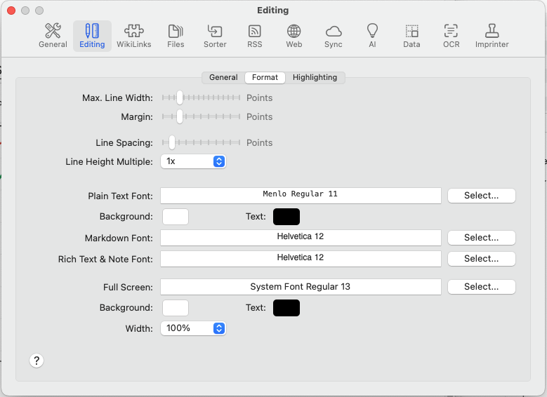

Could you share a document that is affected by this issue? A screenshot of Settings > Editing > Format would be useful too.
Sure, but as I said, a simple lorem ipsum text is sufficient to reproduce this for me. I’ll paste the exact document I use down below.
My Editing settings look as follows:
The document (create a new markdown document, paste the contents, resize the window so that the text no longer fits without scrollbars, type in the last line):

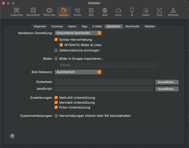

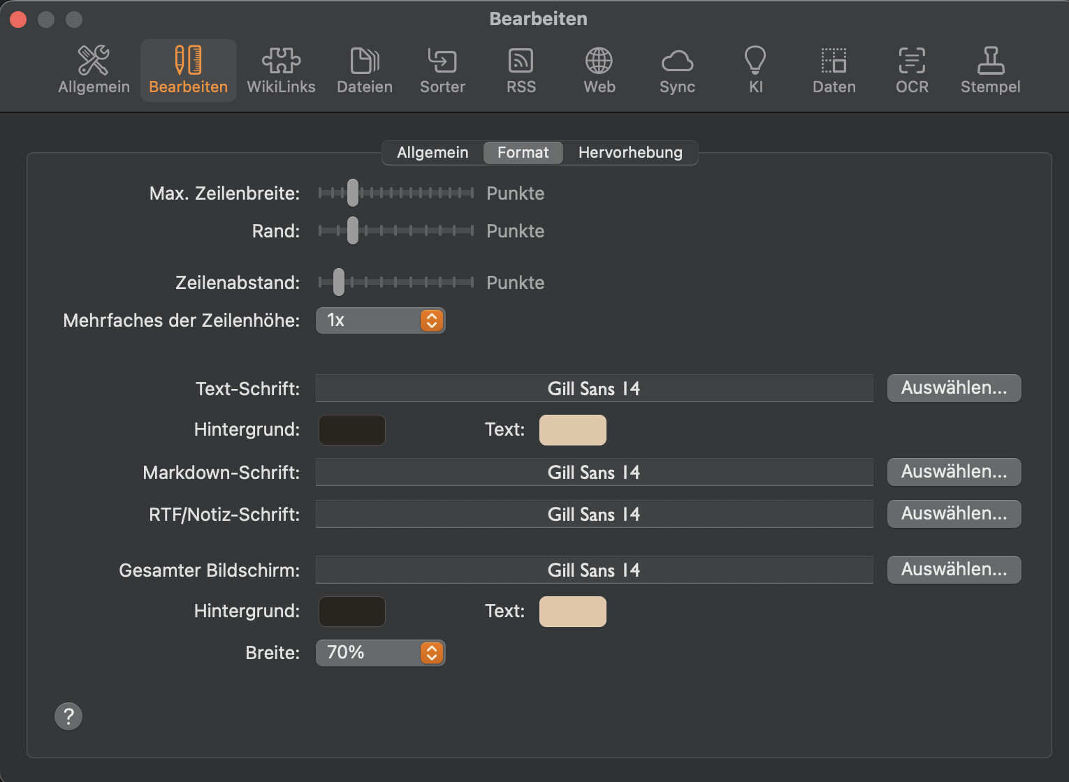

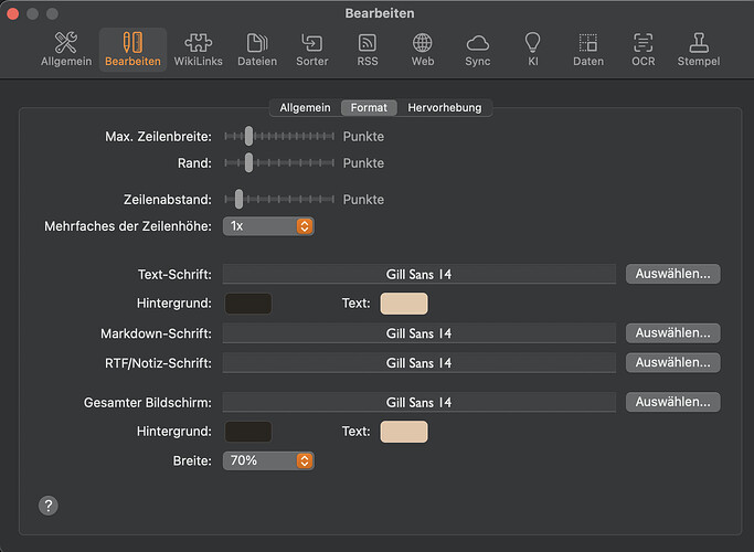

I have the same issue and can confirm that, also in my setup (macOS 15.7.4, DT 4.2.1), it appears to be related to syntax highlighting (disabling it is the only action that seems to have any effect on the “jumping” behaviour)
I paste here below my Editing->Format settings in any case
