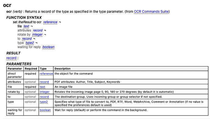

When I check the documentation I see the following:
It seems that the object needs to be specified beside the file and to argument.
I have no clue what that’s supposed to be.

Checking the applescript dictionary of Devonthink I see that the parameter right after “set newRec to ocr” is the reference to the object of the command. Do you know what the parameter reference should be?
So summarizing this I think is should be come something like:
set newRec to ocr UNKNOWN file p
where I don’t know what UNKNOWN represents.
