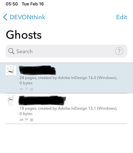

@eboehnisch Eric, I installed 3.02 this morning and I have two PDF documents in the Ghost smart group, and the file info for each shows the size is 0 bytes. However, the documents appear to be fine-one is 18 pages and the other is 24 pages, and all the content is normal. I don’t know if this info is helpful at all, but I wanted to pass it on just in case.
