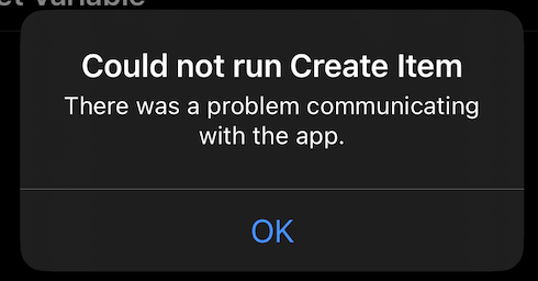

The error still occurs. Here are 2 screenshots to show exactly what this looked like:

Thank you very much for your kind offer of additional testing. I don’t think the problem would be solved by rebuilding the original shortcut (at least, not at this time) because as shown above, a brand-new shortcut containing nothing more than a single Create Item step fails. Single-stepping this new shortcut (and my original, longer one) shows the failure is always the same error (“There was a problem communicating with the app”). This failure happens even if the shortcut doesn’t reference any of my databases (well, other than Inbox) and uses no variables! The test shortcut is as simple as it can be, and it still fails in my environment, on two different Apple devices.

I have this same exact issue on iOS (17.0.3), however NOT on iPadOS.
I didn’t even need to download the shortcut mentioned above, I just setup a very simple shortcut to create a new text document. Fails in iOS (below), but the same shortcut runs just fine on my iPad.

Yea, same outcome with or without text
Just to close the loop on this:
In the end, I had to delete and reinstall DEVONthink to Go, and once it was reinstalled and reconfigured and resynchronized, the shortcuts worked again.
