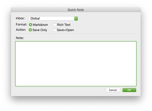

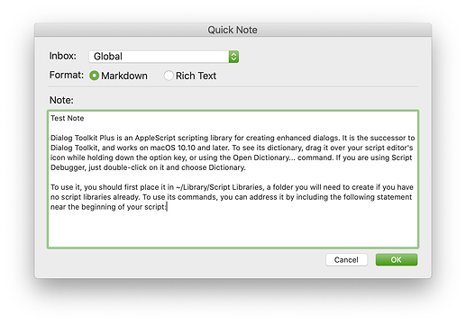

Call the script applet anywhere in macOS. (1) The first line is automatically used as the note’s name and a date string will be added as a prefix. (2) I can choose from three main groups for saving the notes. (3) Note can be saved in markdown or rich text format.

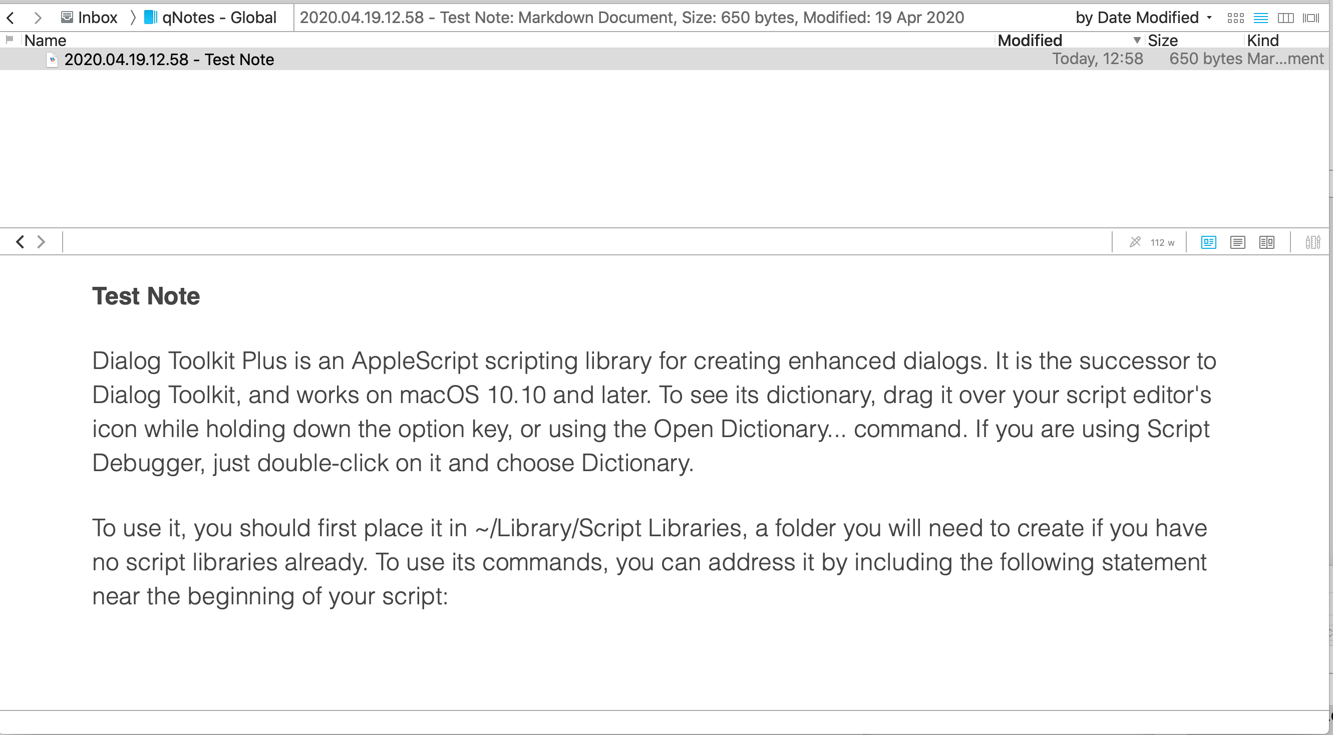

A note is created in DT3. The first line will be bolded if “Markdown” format is used.
