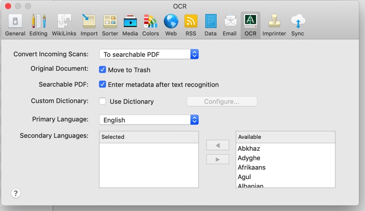

I have that that option turned on and am not offered to rename/tag the file before it automatically imports.
This option enables only the metadata panel, it doesn’t modify the group selector.
So there is no way to rename/tag a file that is scanned before it gets automatically imported into DT as there was in DTPO2?

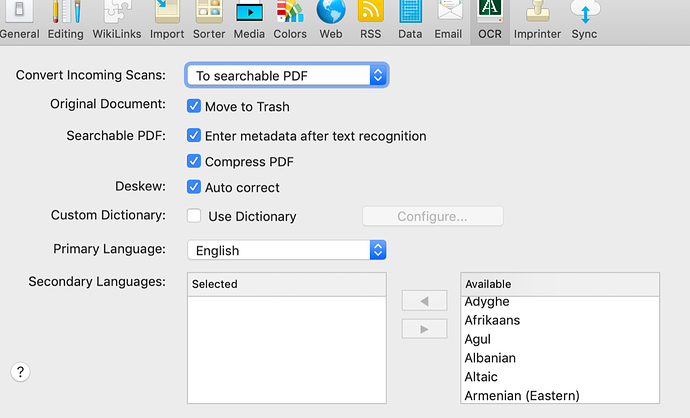

This is my how I have my settings when I did the test above. I receive no prompt to rename/tag the file before it automatically imports into DTb3.
This setting enables only the metadata panel after scanning, it doesn’t have any impact on the group selector (if enabled in Preferences > Import). Therefore this isn’t possible currently.

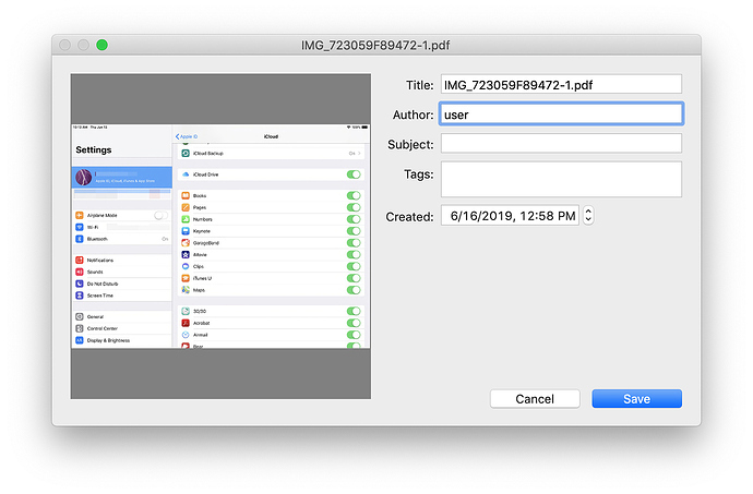

This one:
[/quote]
When does/should this appear during the scan process?
After sending the scan to DEVONthink as soon as OCR is complete (if the option to convert incoming scans is enabled).

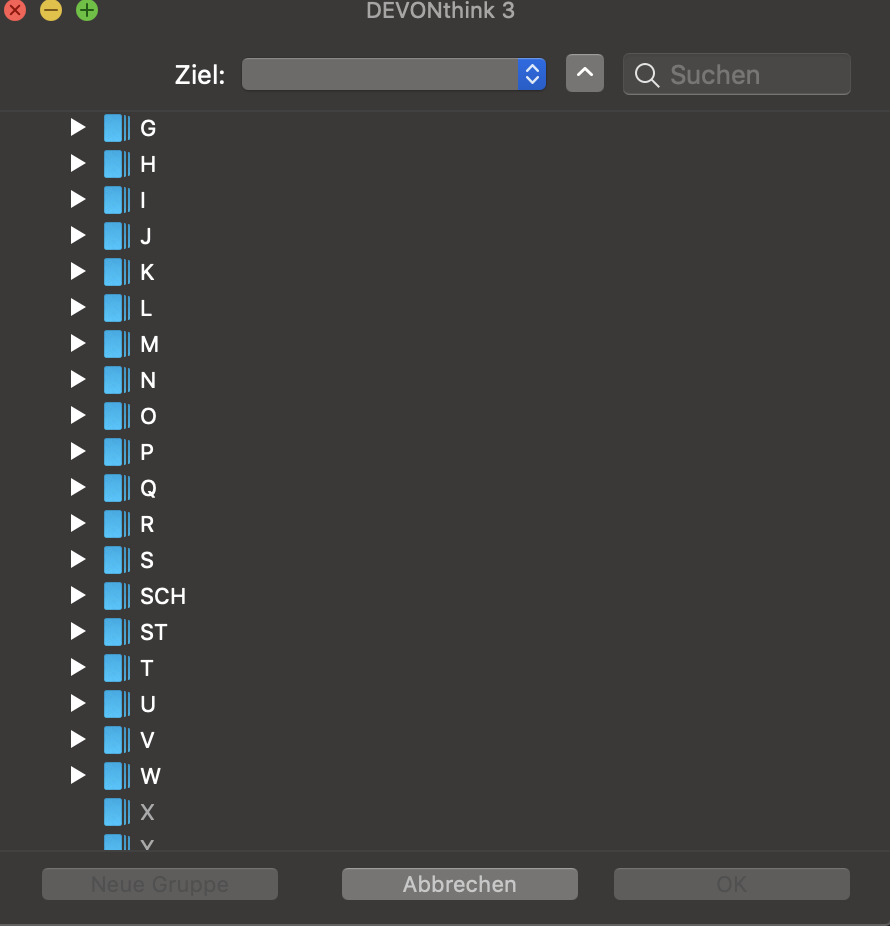

Currently it is like this, if you start the scan, then only the folder for filing the file appears. The rename after the scan then you have to do within the database.

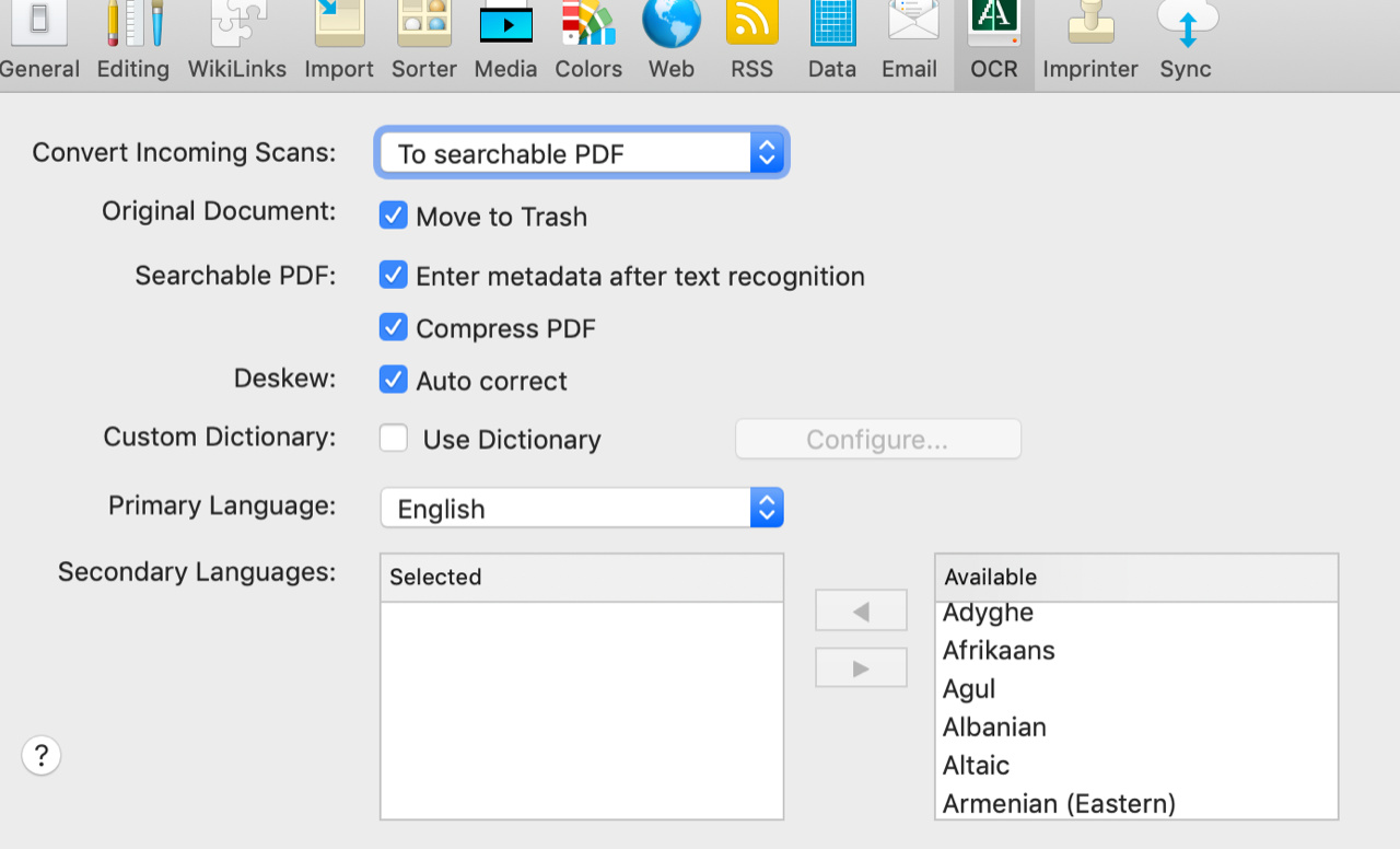

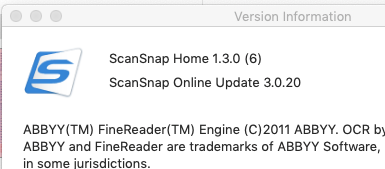

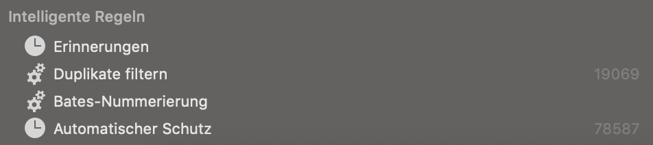

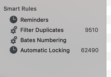

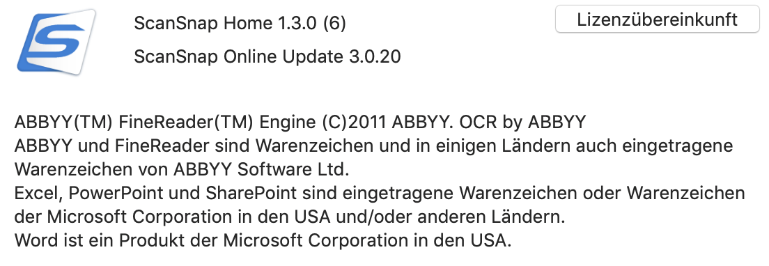

Which version of macOS and of ScanSnap Manager or ScanSnap Home do you use? A screenshot of Preferences > OCR and of your smart rules would be great too. Thanks!
15%20PM
35%20PM
49%20PM

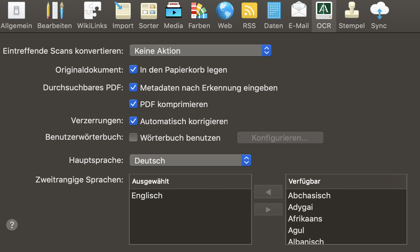

Bei mir ist es ebenfalls nicht vorhanden.
hier meine Daten:
50
Das Scanfenster nach dem Scan mit ScanSnap ix500:
Hier kann ich immer noch nicht den Dateinamen sofort angeben. Ich kann nur das Ziel auswählen, und ablegen.
Danach muss ich in den Ordner + Unterordner gehen um den Dateinamen zu vergeben.
Die ist nicht das Metadatenfenster, sondern die Gruppenauswahl, die je nach Einstellungen > Import > Ziel verwendet wird. Die Metadateneingabe, die in Einstellungen > OCR aktiviert ist, sollte davon unabhängig erscheinen und so aussehen:
