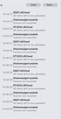

I downloaded and installed 3.8.3. I keep several sync copies in local files and since the installation the log tells me that a particular volume is not mounted. I do not remember wher this Volume is. How do I get it to stop doing it this every few minutes. THanks for anyhelp you can give.
A screenshot of the message would be useful.

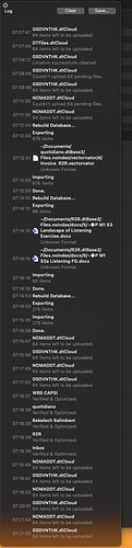

I do not know what these 64 items are and at this stage I dont care I just want to fix the problem. Hers a screen shot of the log
Check out “Repairing a Defective Database” in DEVONthink Help, or better yet the same is in the outstanding “DEVONthink Handbook” page 189 of the new 3.8.3 version.

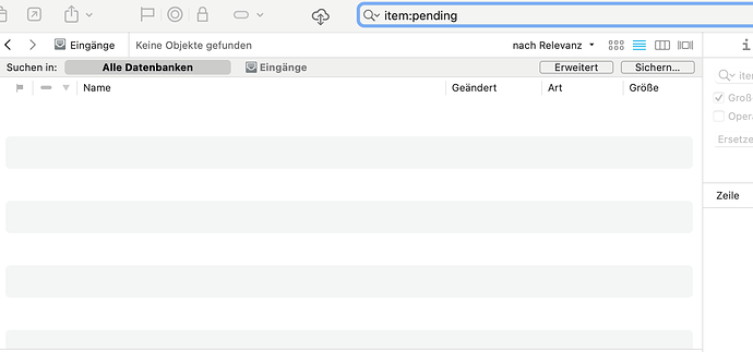

I have deactivated and reactivated my webdav. Before the update it also worked without problems. I also had my database repaired.
Did you do the search for item:pending ?
