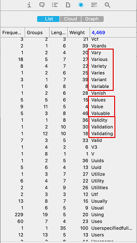

About the new concordance, one thing I thought of suggesting to @cgrunenberg is allowing similar words to be grouped together so that they would appear as a single thematic cluster. I don’t know how feasible this is though.
similar words
What do you mean by similar? This is what I think of when I see that phrase…

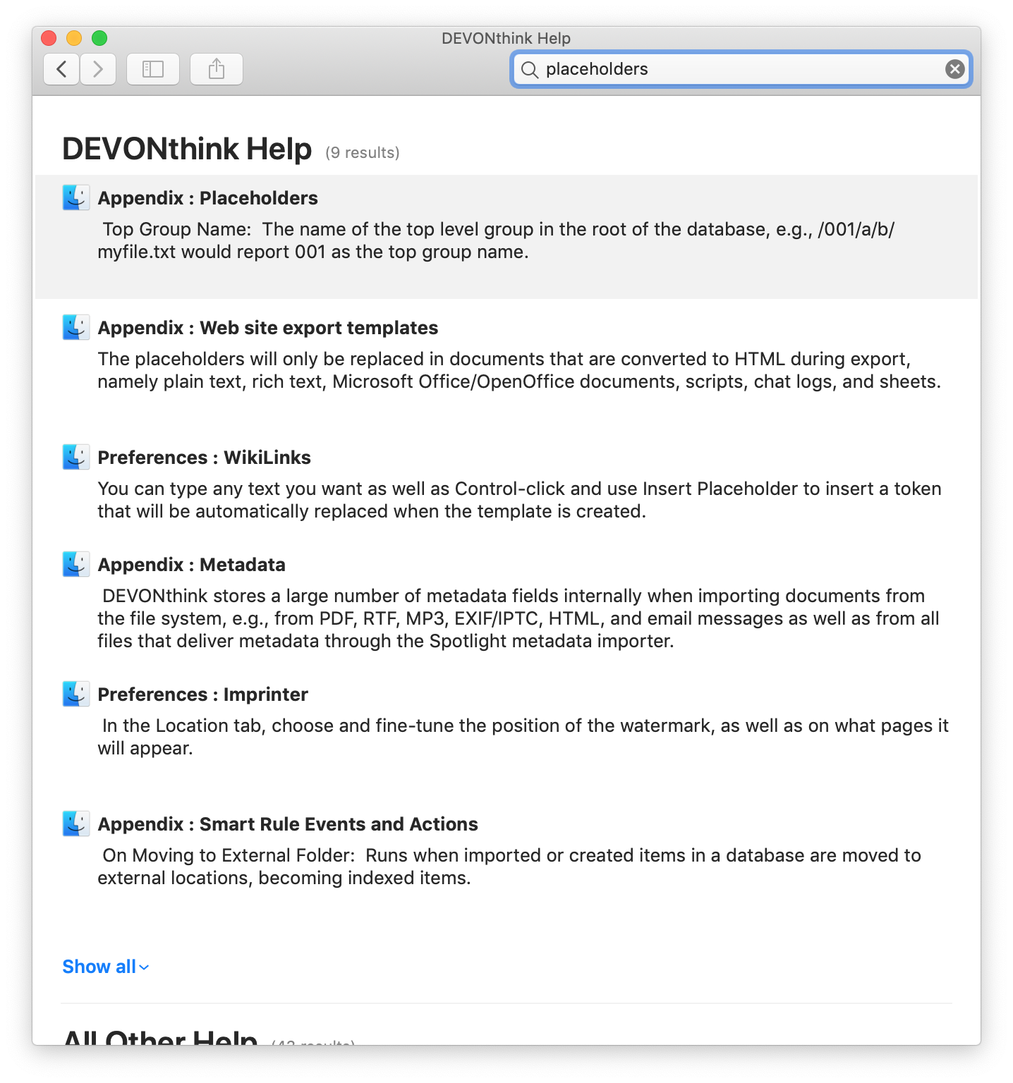

PS - for anyone wondering about placeholders:
Words that bear family resemblance, perhaps? To be clear, this would have to be chosen by the user not the algorithm.

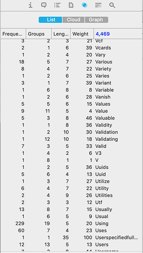

Isn’t that pretty much what sorting on the word column is already producing?
No, because:
  1. you can have words similar in form, but different in meaning;
  2. in both cases you cannot group these words together and get an actual picture of how prevalent a determinate theme is among others (at least as far as the concordance panel goes).
The Concordance doesn’t show you contextual relationships or themes. That’s up to the interpretation of the individual.

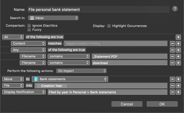

I’m a new user (as from the launch of DT3) so this is probably not the most sophisticated of examples but, for what it’s worth, here is a smart rule incorporating a placeholder:

Thank you for sharing this! I created not one, but two smart rules based on this.

Wouldn’t the filename contains download lead to unnecessary hits? I’m not sure what including that adds to the functionality of the rule, or am I trippen?
For me the rule works perfectly—because of the combination of the content match (which I have obviously obscured in my screen shot) and the file name. Effectively that combination is unique.
