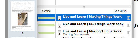

Added: screenshot duplicates

Try opening the document in its own window, then using the See Also & Classify (Hat icon) pane to work with duplicates. Your open document is the top item on the list, and all the duplicates will (at least should) appear first under the open document. Here you can view the duplicates to confirm that they are indeed duplicates, or move/delete them if needed. The path of the document in the database will appear under the document name. You can Command-R to reveal documents, but there really isn’t any need to do so. The open document will always remain at the top of the list, so you can always click on it to return ‘home’ if you are following a rabbit hole when clicking on additional documents in the list.
The See Also & Classify pane is perhaps the single most important feature of DEVONthink for me. I can accomplish so much from this view-move indexed documents into the database, classify them to another indexed location, move them back out to the Finder, copy and paste text from/into other documents, copy and paste tags to/from documents, replicate documents, and etc., etc.
